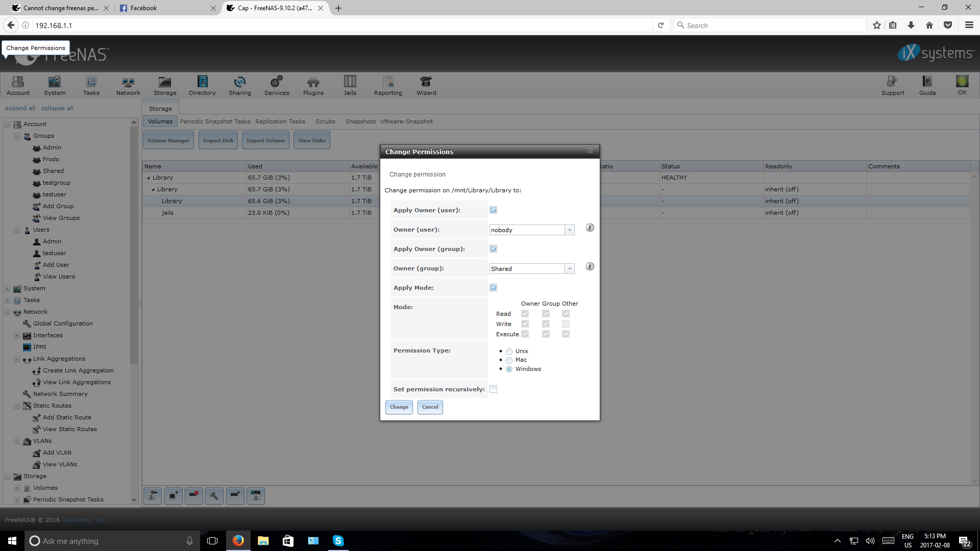

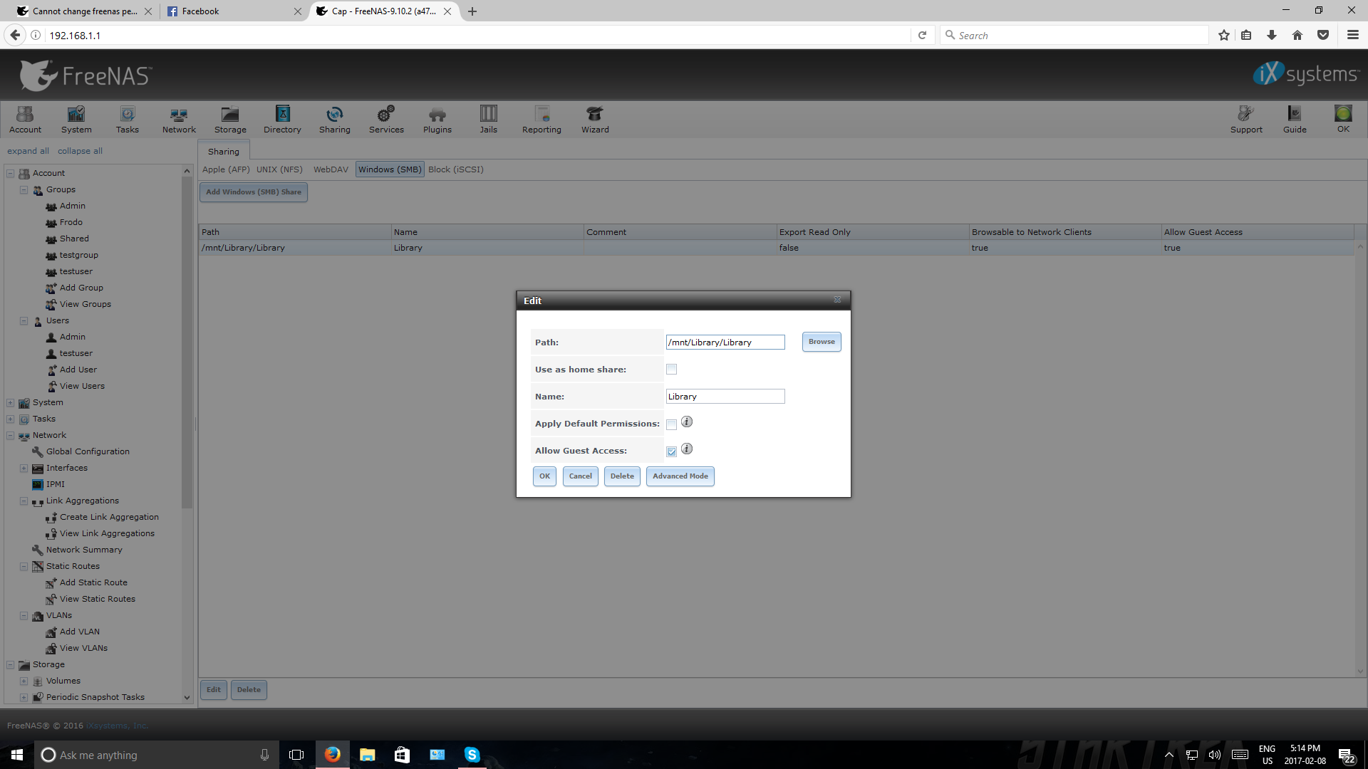

I asked already. Share info and dataset info. Also what users are authenticating
Chazore
Jan 21, 2017
9

And what happens when you access the share with the nobody user or a user in the shared group?
After you connect run smbstatus on the cli in freenas. You will probably need to use SSH to get all the output. Post it to pastebin and provide the link here.
