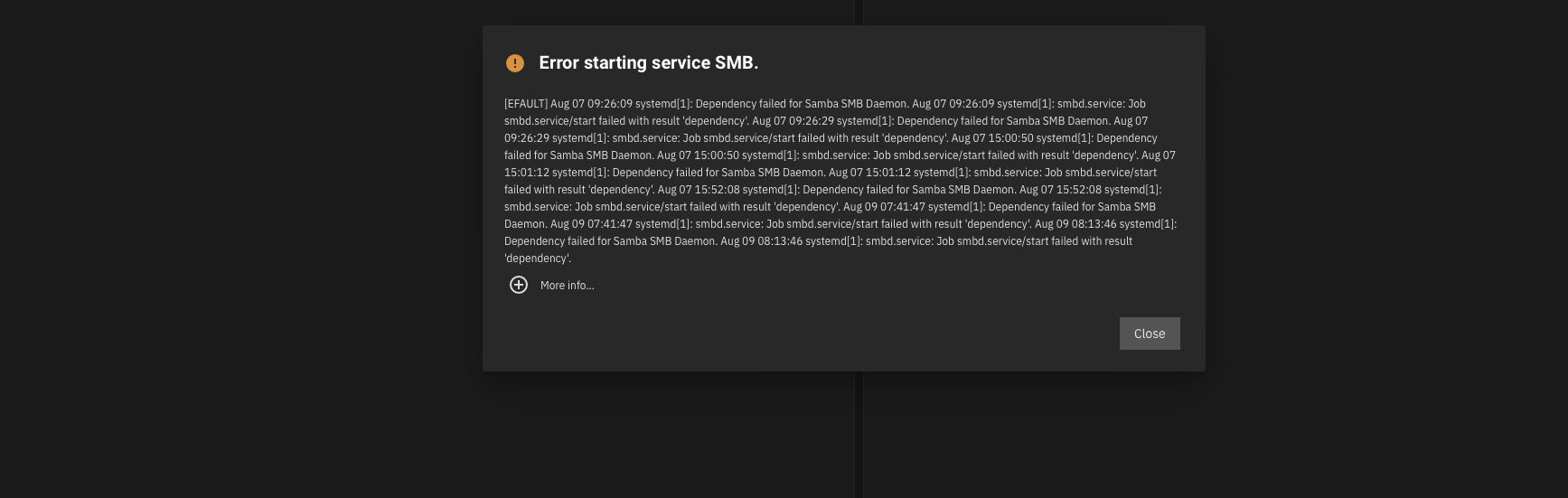

I recently changed the motherboard of my scale build and I have not been able to restart my smb services. I receive the following error message regarding a dependency and I observed an incorrect date.

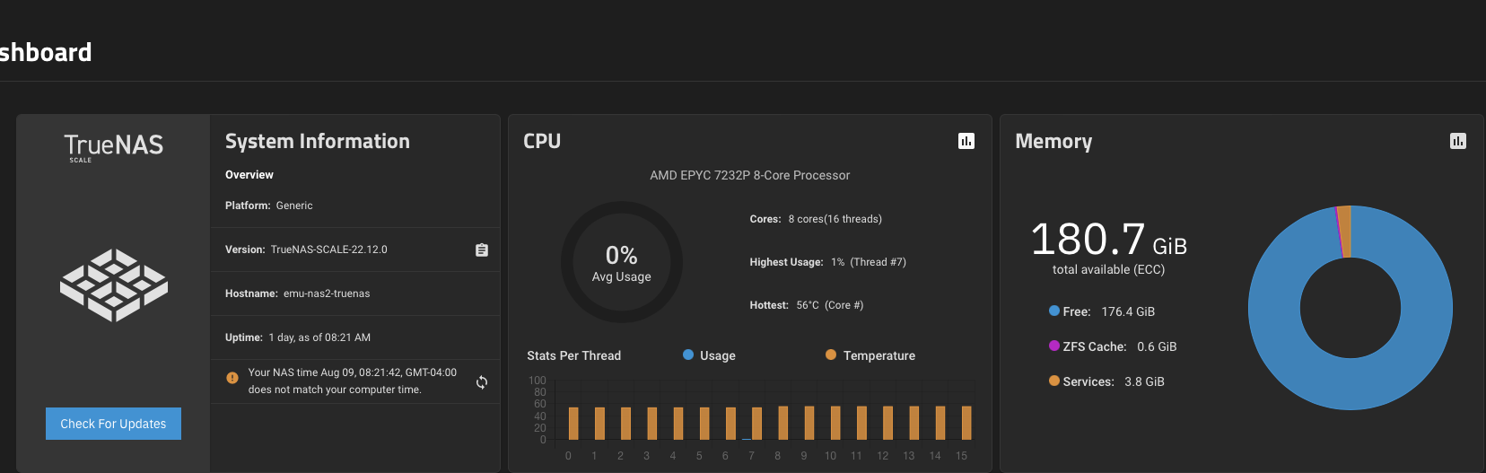

The incorrect date is also present in my dashboard

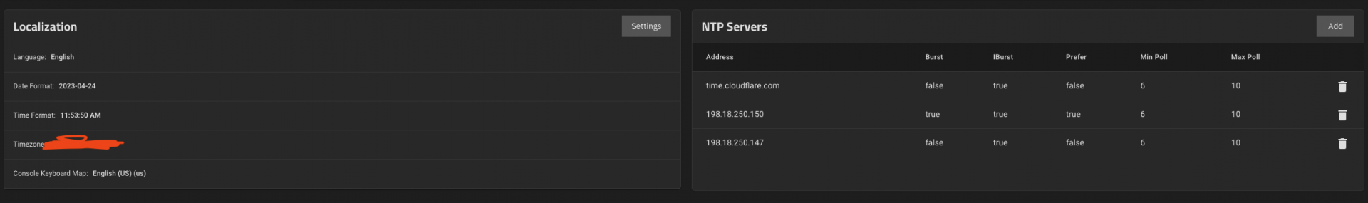

What is unusual is that under my NTP settings, i show the correct time from my internal NTP servers. Is there any correlation? If not, not sure what steps to re-enable SMB/NFS

Please report your hardware
Its likely that the clock on your motherboard is wrong.
