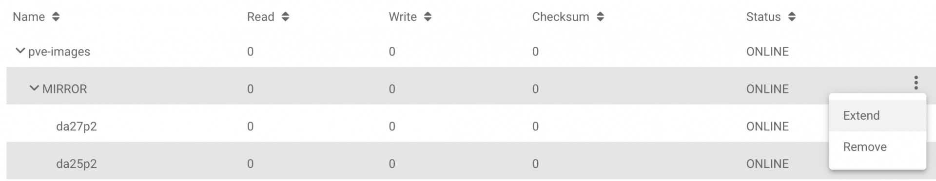

Can I just disconnect 2 disks from pool2 in the Truenas UI and then import them as 5th mirrored vdev to pool1?
Yes. Go to the pool status page of pool2, click the kebab menu next to the pair of disks you want to remove, and select Remove. Looks like this:
