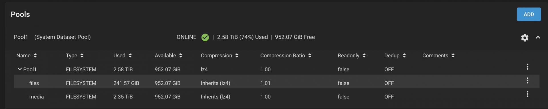

I currently have a pool that has mirrored 4TB drives. Is it possible to added a pair of mirrored disks to the original pool/vdev?
This is my current setup:
spuky
Oct 11, 2022
60
yes just click the cog on the right and "add vdev" you then can select 2 disks and add them as another mirror...
