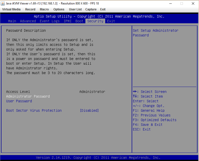

Ok, fired up the test box with the X9SCM board and went into the bios.
I went to the security tab and put in a password for admin as well as user
and chose the SETUP option. (meaning you need password to enter bios only)
Rebooted.
The bios came back up with a password window. (Hal said, "I'm sorry Dave, I can't do that.")
I held in the case's power switch for 3 seconds.
I then used proper ESD procedure and removed battery,
and for good measure,
I held a small screwdriver accross the pads at JBT1
(for about 10 seconds just 2b sure)
After about 6 min. I popped the battery back in, hit the rocker
switch on the PSU.
I hit the case's power switch and booted into the bios (no password window)
Complete success!

Just done exactly like you did ,twice, and.... still the damn password screen. I'm guessing its faulty board :( .

I've done many CMOS resets, but I've never seen a board that requires a password to boot or get into setup after a proper CMOS reset. My guess is that either you haven't completed the resest correctly, or the board is indeed faulty in some way. I recommend you talk to Supermicro support.

I've managed to solved the bios password problem.

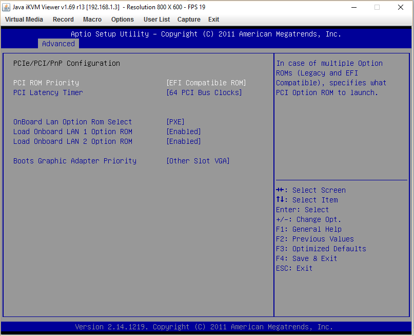

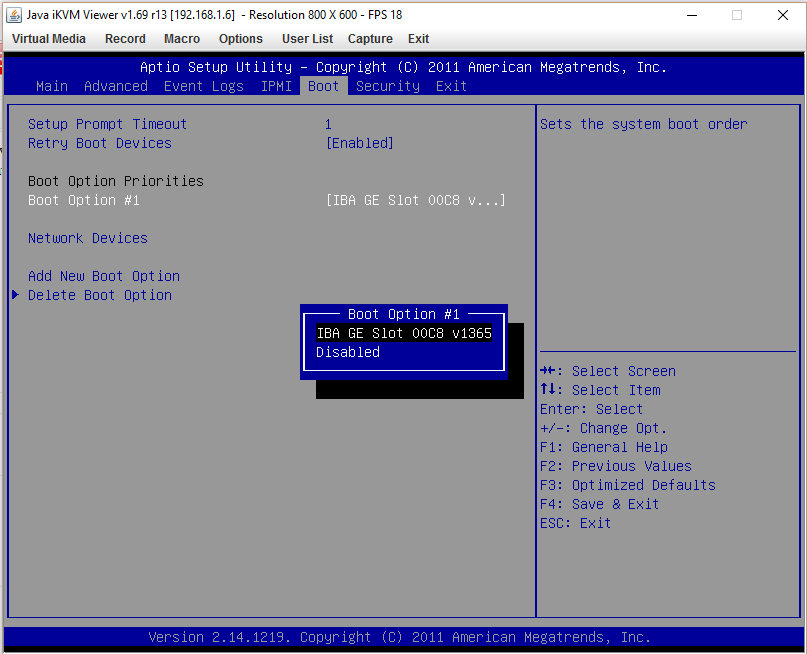

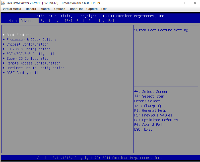

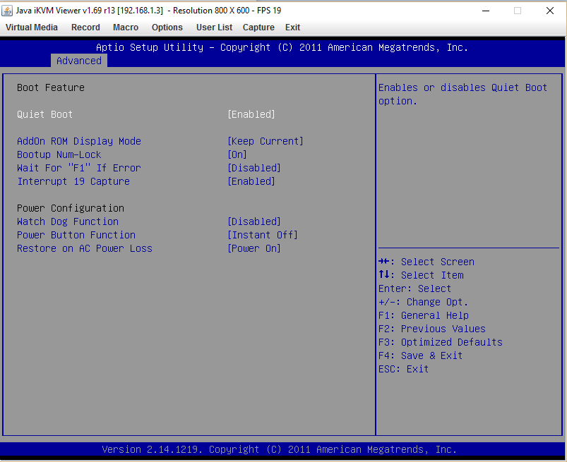

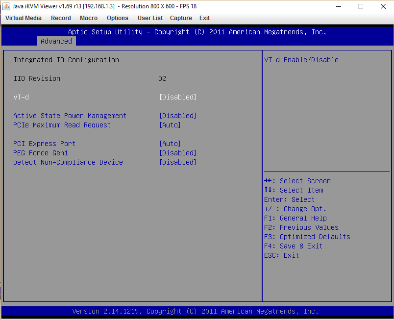

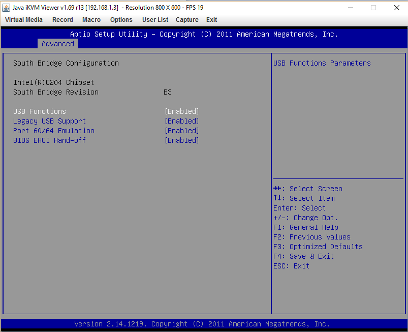

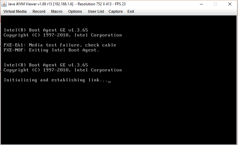

You're right there is a legacy mode which is enabled but still can't detect the usb. I'm going to take screenshots of all the bios options and put here, maybe is something i'm missing.
meeks
Mar 11, 2016
20
Sorry about the dealy, had an emergency.
Here are the bios options.

Please clarify, is it the installer USB that doesn't show up as a boot device, or have you installed to a USB device, and it is the latter that will not boot?
meeks
Mar 11, 2016
20
Its the installer that doesn't work. I tried freenas iso, windows iso, i even tried a freedos usb to re-flash the bios and nothing is detected.

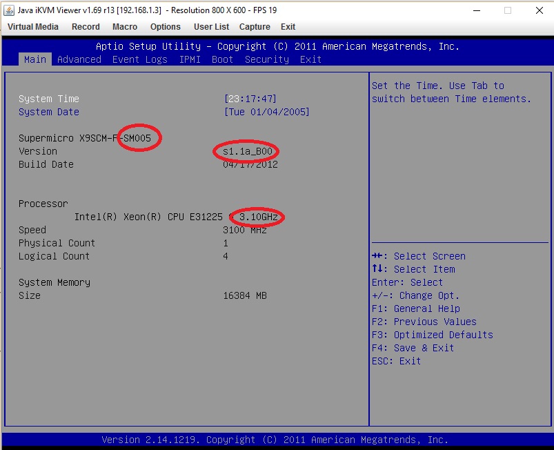

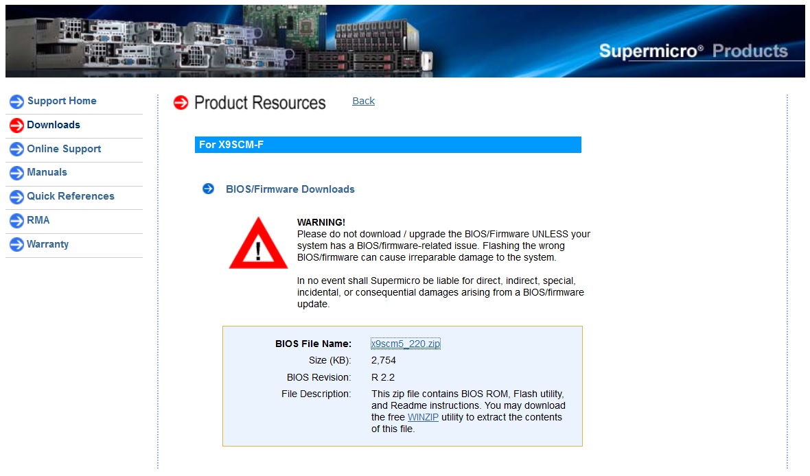

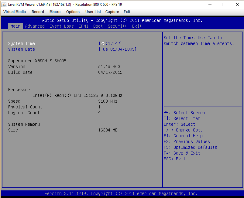

Sorry for taking so long to respond (been super busy).
After taking a quick look, I notice a couple of things;
  1. Supermicro does not recommend the Xeons with graphics for this board. (all E3 cpus ending in 5 have on-board graphics)
  2. The bios revision number suggests custom bios for a proprietary board. (latest bios for this board is version R2.2)
  3. According to ARC Intel specs, your cpu should be 3.2GHz and bios lists it as 3.1 ????
  4. I've never seen the extra numbers after the model number (SM005), I think this also may suggest a proprietary unit.
Recommend you attempt flashing bios to version 2.2 and also using a non-graphics cpu.
