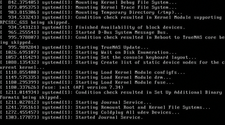

I've been trying to get the TrueNAS upgrade to Bluefin to boot properly.  If I do a fresh install, the first boot will work.  However, once I restore my config and reboot it doesn't work.  If I just run an upgrade from Anglefish the first boot fails.
Sometimes it hangs for a VERY long time going very slowly line by line over a few hours, but never actually boots. Othertimes it gets to this part and never goes further.
This system does not have console port but I tried the suggested work around of removing the serial tty from grub. That has had no affect.
At first I thought the issue could be with my TPM so I disabled it and tried again. While it goes rid of the FIPS self test error, it still hangs at the same part.
Some of the testing i've been doing has been with an SSD connected by USB so I don't have to keep reinstalling each time I give up and go back to it running my VMs normally.
