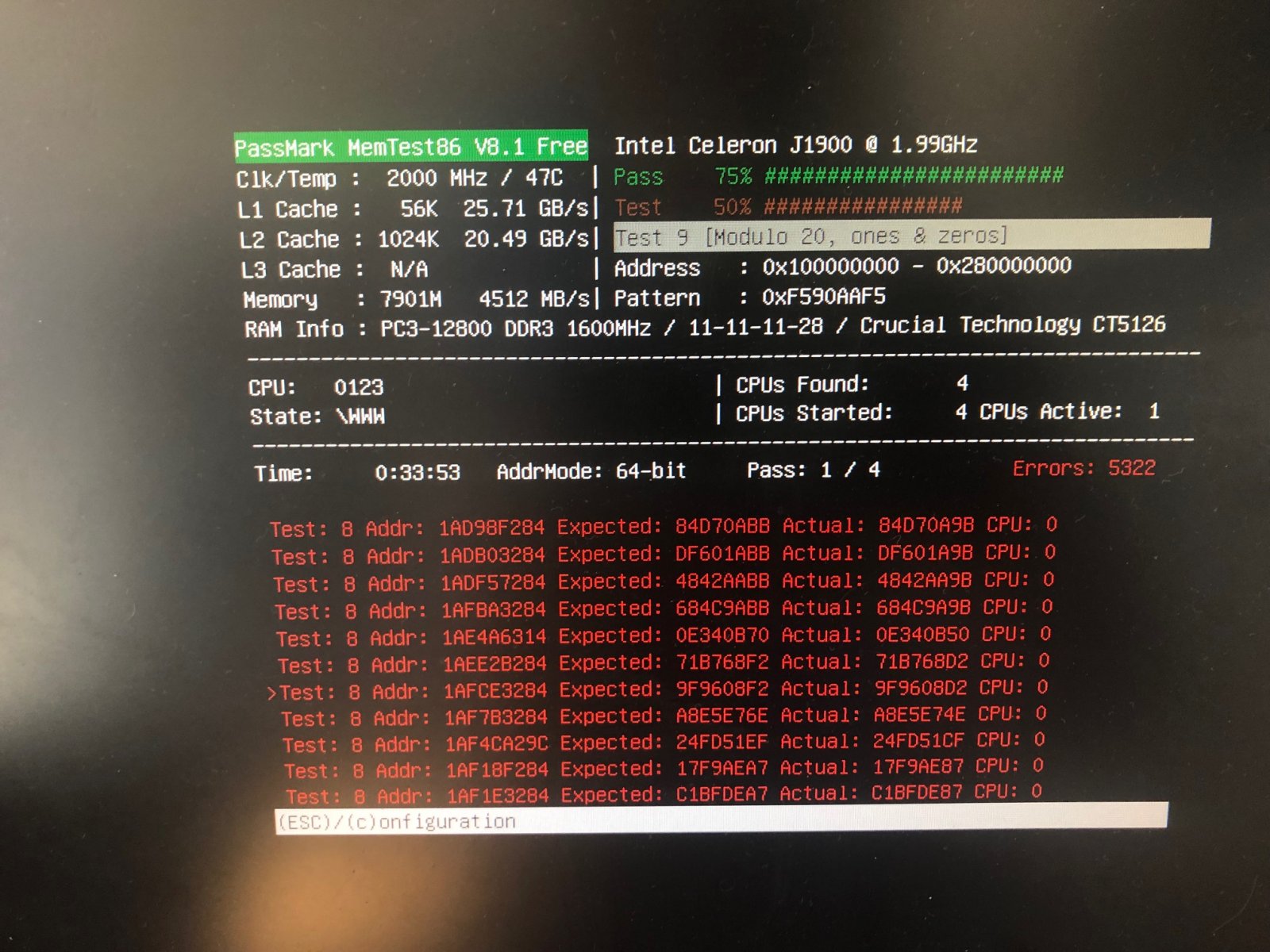

Hello together,
I have a big issue with my freenas. My both pools (for the os (name: freenas-boot) and for my data (name: pool)) were degraded with a lot of errors:
frenas-boot is a SSD, connect with usb3
data pool are 4 WD RED 4TB as raidz-1
Yesterday I had time for a new build. At first I change my bios battery (because of problems with the bios settings after power disconnetions)
So I upgraded my freenas from 9.10 to 11.2-U3, save my configuration, did a fresh new installation on my ssd, upload my old configuration, destroy my data pool, create a new raidz-1 data pool and create the datasets.
After this I start my rsync job from my backup server to my freenas but my freenas did many reboot itself and my rsync job died. So I did it again...and again.
So after last night my new freenas-boot pool is DEGRADED and for my new data raidz-1 pool had new Permanent errors on files:

If I start my rsync job the freenas system will get a reboot.....but Why?
Specs:
8GB non ECC RAM (I know its not ECC! :( )
board Q1900-ITX from ASRock with Intel(R) Celeron(R) CPU J1900 @ 1.99GHz
Be quite PSU
4 WD RED Disc (SATA)
1 small SSD with (USB3)
Intel EXPI9301CTBLK PRO1000 Netzwerkkarte CT PCIex bulk
My system between 4 and 5 years old...
The SMART tests are ok.
Do you have any ideas?
Thanks a lot.

Hi artlessknave, thanks for your answer. I think the errors after the fresh installation cames from the crashs of the rsync jobs. How can I check my boot drive?
I can't understand why the system will get a reboot (without shutdown) if I start my rsyncs.

I got these messages from my NAS (mail):
freenas.local had an unscheduled system reboot.
The operating system successfully came back online at Sat Apr 6 09:26:39 2019.
Why do you think raidz1 is generally not recomended?
Regards
lnix

I'd start by running a check of all the individual hardware, specifically the memory. PSU is also questionable.
artlessknave
Oct 29, 2016
1,506
Why do you think raidz1 is generally not recommended?
long resilver times for large disks vastly increases the chances of another disk failing before the pool is rebuilt. if you have a backup server it's less of a problem, but you should know that raidz2 is recommenced for the majority of users.
Yes be quit isn't a enterprise
the PSU doesn't need to be enterprise, as there aren't really any available in standard atx form factor, but there are reliable, well built PSU's known to provide good clean stable power, and the point is to eliminate possible problems. replacing with the same hardware doesn't really do that.
nothing from those smart reports jumps out at me as being bad, and while I still recommend getting a reliable PSU with more wattage, it doesn't look like that's the problem.
you can replace your sata cables, but your non ECC memory is probably the next thing to check, I didn't think of it before, but random reboots can definitely be from memory errors; get memtest86 and run it for at least one full pass, and then a full day if no errors are found (your non ECC memory needs more testing than ECC would need)
seriously consider getting recommended hardware or if freenas is the correct path for you, particularly if you arent even using replications, one of the primary advantages of zfs for backups.
problems like this are why quality hardware is pushed so hard; few people want to spend a ton of their time to troubleshoot problems that following the hardware lists usually solve.

Just now it happened the next reboot. Here ist my log (/var/log/messages)
On my Console the first message was a freenas Fatal trap 12: page fault while in kernel mode

I'm not super strong in syslog, but I'm pretty sure page faults are memory, and that tells me that your non recomended RAM, unsurprisingly, is killing your pools, which is why it's not recommended.
memtest time. figure out which sticks are bad and replace them. or better yet replace the mobo/cpu/ram
lnix
Aug 16, 2014
29
I did a first memtest and there are a lot errors...I will test each module. Tommorrow I will get my new mem and I will test it again with the new mem. If there any errors I will buy server mobo/server cpu/ecc-ram in mini-itx
artlessknave
Oct 29, 2016
1,506
excellent, glad we found the problem.
