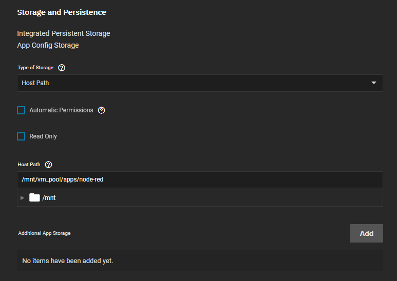

I wanted to try out Node-red (available in TrueCharts) so went for the install button but here is where the problems start and I think I can map it to a single root cause (configuration persistency). So my "investigation" told me that "Host path" is the best choice and I tried it to configure but failed to do so because of what looks to me as missing options. Google resulted with absolutely no answers so this tells me either I'm doing something wrong no one else did or my noob level is so damn high I can't even ask the right questions...

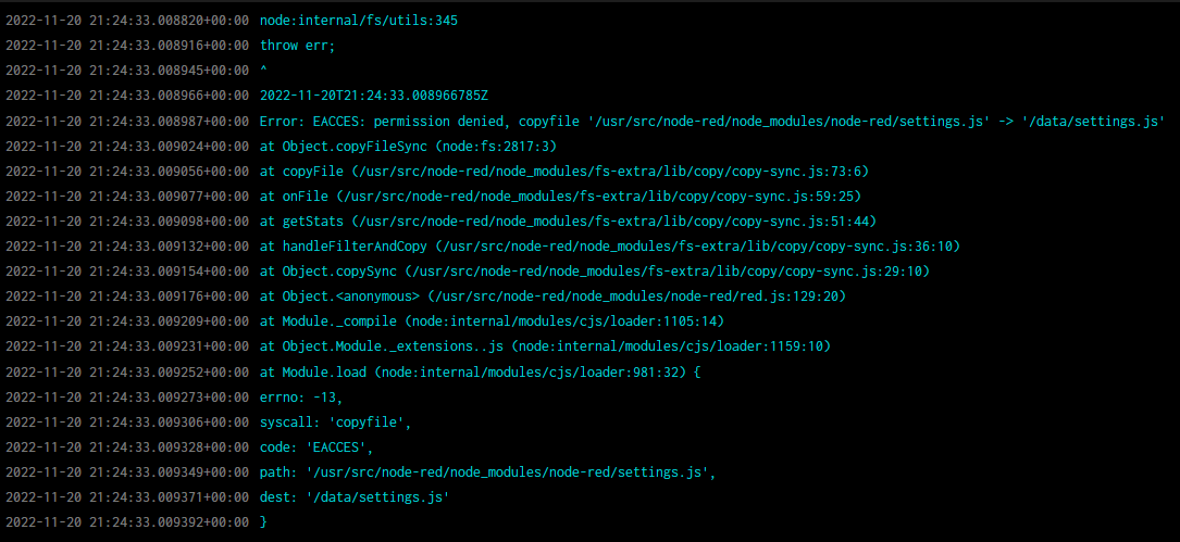

- If I choose "Host Path" for the configuration I'm missing the "mount path" option so I'm not sure what TrueNAS does in this case but it is not good as an app (or pod or whatever is the correct term) fails to start with EACCESS and message that .json file cannot be copied to /data location (at this moment I think this is an internal location for persistent data of an app). An interesting fact is that if go for the "Additional App Storage" I see this option but configuring this in addition to the main "App Config Storage" option does not result in the working configuration as well. I cannot skip the main option and do only "Additional". Also to add I tried with and without "Automatic Permissions" as this was the first thing I thought was the answer to this problem.

- [TrueNAS] why do I see different options from app to app during the install steps? For some apps, it was possible to set up only extra host paths (and there it was called extra and not additional) which I could map to the correct internal path which could be the reason why they worked and this one did not.
