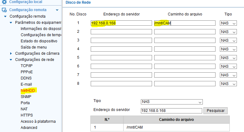

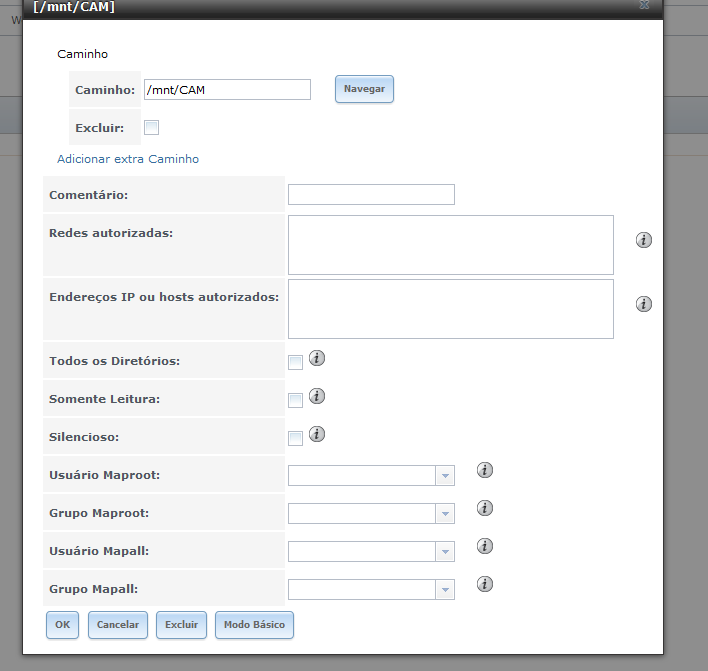

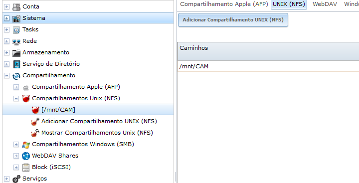

Good afternoon friends,
I have a DVR brand TecVoz model T1-STVI16 / S. This equipment has the option of nethdd, to backup the cameras on a NAS. I've virtualized the freenas 9.10.1-U4 in Vmware and set up a 10GB share on NFS unix for testing. The DVR finds the share via ip, but when I try to format an error message: Initialization error. Anyone know what I can do to solve it? Thank you

snaptec
Nov 30, 2015
502
You can't remove permissions.
Try to set dataset to root:wheel (should already) and set in the nfs share (your 4.png) the first map root to nfs.
Maybe try from a different client to mount and write to the share.

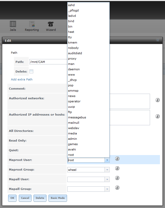

Straider2
Jan 9, 2017
5
Hello snaptec. Is it to put nfs on this screen? I could not find it. Thanks

snaptec
Nov 30, 2015
502
root:wheel should be ok.
The same should be set unter storage for your dataset (should already be root:wheel) and try again
