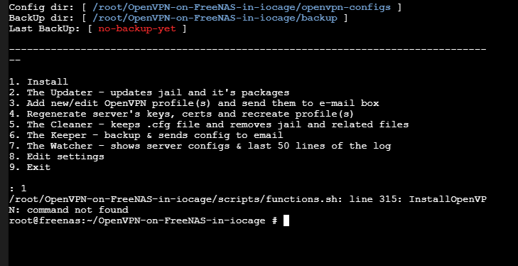

I try to download the script and run, but says that, how to proceed please.
1. Install
2. The Updater - updates jail and it's packages
3. Add new/edit OpenVPN profile(s) and send them to e-mail box
4. Regenerate server's keys, certs and recreate profile(s)
5. The Cleaner - keeps .cfg file and removes jail and related files
6. The Keeper - backup & sends config to email
7. The Watcher - shows server configs & last 50 lines of the log
8. Edit settings
9. Exit
: 1
/root/OpenVPN-on-FreeNAS-in-iocage/scripts/functions.sh: line 315: InstallOpenVPN: command not found
I'm running TrueNas 12.1
Installer gets scripts from directory based on Freenas version.
I have Truneas 12.2 which is merged with Freenas 11.3, so i renamed the OpenVPN-on-FreeNAS-in-iocage/scripts/11.3 dir to 12.2 and instalation went fine.

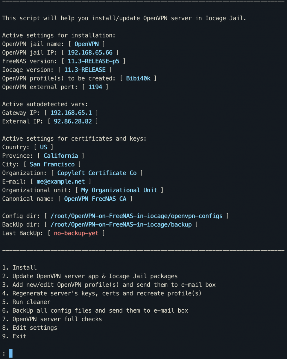

Hi all,
after i have maintained a manually step-by-step tutorial i decided to create a script to do all necessary steps for us all.
Change log: 0.4 - 2020.05.07 - Completely new script with menu
0.3 - 2020.02.25 - Starting Wiki - Git-useful-commands
0.2 - 2020.02.25 - BUGFIX: Email is not read at first run
0.1 - 2020.02.18 - the first commit
What this script do:
- check for new version on each run and update itself
- create all dir structure and files on you
- store all configuration files into 'openvpn-configs'
- create iocage Jail with proper values and configurations
- build Certificate Authority
- build Server Certificates
- generate Diffie Hellman Parameters
- generate the TA key
- build Client(s) Certificate
- copy everything together and set paths to OpenVPN server config file
- creates the firewall and routing tables
- mix all certs and keys together with client(s) config files and create a single .ovpn file useful for mobile also.
- sends email with client(s) config file.
Recommended OpenVPN Clients:
Windows: OpenVPN
MacOS: Tunnelblick
What you should do:
- edit the config file
- during the installation you'll be asked to create a PASS PHRASE which you'll be using to authorize further operations like generating certificates, keys, users
- forward chosen port (default 1194) to OpenVPN iocage Jail chosen IP (default .66) on Port 1194 UDP
- keep in mind that if your local LAN uses the extremely common subnet address 192.168.0.x or 192.168.1.x this might create routing conflicts if you connect to the VPN server from locations that use the same subnet (work, public wi-fi, hotels, etc).
Installation steps:
SSH into Freenas
ssh your-username@your-FreeNAS-IP # Terminal for MacOS & Linux or Putty on Windows
sudo -i # we need to be root
Download installer
git clone https://github.com/Bibi40k/OpenVPN-on-FreeNAS-in-iocage.git
cd OpenVPN-on-FreeNAS-in-iocage # Enter the script dir
Start installer and follow on-screen instructions
./install.sh # run the script and enters the menu
Good luck all and i'm waiting for feed-back.
@Bibi40k Looks like the script has broken as it cannot find "InstallOpenVPN"

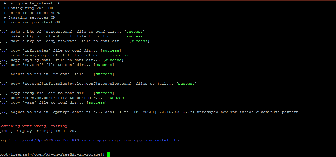

I am running TrueNAS version 12.2 so I copied the scripts/11.3 folder to scripts/12.2... At least I didn't get a fatal error missing InstallOpenVPN.
I did get the following errors though:
1. Install
8. Edit settings
9. Exit
: 1
[..] checking config dirs... [success]
[..] appserver jail creation in progress... appserver successfully created!
Testing Host DNS response to pkg.freebsd.org
Testing appserver's SRV response to pkg.freebsd.org
Testing appserver's DNSSEC response to pkg.freebsd.org
Installing pkg...
You may need to manually remove /usr/local/etc/pkg.conf if it is no longer needed.
Installing supplied packages:
- nano...
- openvpn...
===> Creating groups.
Creating group 'openvpn' with gid '301'.
===> Creating users
Creating user 'openvpn' with uid '301'.
Message from easy-rsa-3.1.0_2:
NOTE: easy-rsa will require you to initialize a pki ONLY UPON FIRST USE.
The packaging itself no longer does this because that would confuse easy-rsa,
and easy-rsa expects the vars not to be per-installation, but per-PKI.
ONLY for the very first run for a new PKI, do something such as:
easyrsa --pki-dir=~/my_new_pki init-pki # DANGEROUS - DESTROYS ~/my_new_pki
which will copy vars.example both into ~/my_new_pki
and create another copy named ~/my/new_pki/vars for you to edit for this PKI.
Then, edit ~/my/new_pki/vars to set the defaults.
After upgrades, use other commands, explained by running: easyrsa help.
to explain options such as --pki-dir (see above), run: easyrsa help options
Message from openvpn-2.5.7_1:
Edit /etc/rc.conf[.local] to start OpenVPN automatically at system
startup. See /usr/local/etc/rc.d/openvpn for details.
Connect to VPN server as a client with this command to include
the client.up/down scripts in the initialization:
openvpn-client <spec>.ovpn
For compatibility notes when interoperating with older OpenVPN
versions, please see <http://openvpn.net/relnotes.html>
Note that OpenVPN does not officially support LibreSSL.
Note that OpenVPN configures a separate user and group "openvpn",
which should be used instead of the NFS user "nobody"
when an unprivileged user account is desired.
You may want to add user openvpn and group openvpn when creating your
configuration files, the example configuration shows this only as comments.
- mpack...
* Starting appserver
+ Started OK
+ Using devfs_ruleset: 1002 (iocage generated default)
+ Configuring VNET OK
+ Using IP options: vnet
+ Starting services OK
+ Executing poststart OK
[..] make a bkp of 'server.conf' file to conf dir... [success]
[..] make a bkp of 'client.conf' file to conf dir... [success]
[..] make a bkp of 'easy-rsa/vars' file to conf dir... [fail]
[..] copy 'ipfw.rules' file to conf dir... [success]
[..] copy 'newsyslog.conf' file to conf dir... [success]
[..] copy 'syslog.conf' file to conf dir... [success]
[..] copy 'rc.conf' file to conf dir... [success]
[..] adjust values in 'rc.conf' file... [success]
[..] copy 'rc.conf|ipfw.rules|syslog.conf|newsyslog.conf' files to jail... [success]
[..] copy 'easy-rsa' dir to conf dir... [success]
[..] copy 'openvpn.conf' file to conf dir... [success]
[..] copy 'vars' file to conf dir... [success]
[..] adjust values in 'openvpn.conf' file... [success]
[..] adjust values in 'vars' file... [success]
[..] copy Easy RSA vars file to conf dir... [success]
[..] generating PKI...
Something went wrong, exiting.
[info] Display error(s) in a sec.
Log file: /tmp/OpenVPN-on-FreeNAS-in-iocage/openvpn-configs/ovpn-install.log
No default gateway found for ipv6.
cp: /mnt/pool/iocage/jails/appserver/root/usr/local/share/easy-rsa/vars: No such file or directory
/tmp/OpenVPN-on-FreeNAS-in-iocage/scripts/keys.sh: line 20: ./easyrsa.real: No such file or directory
So I assume that copying the folder didn't really help... Any suggestions?
Stuck on the same step exactly.
Still need this script cause the built-in service refused to load

The script failed in line 20 keys.sh when trying to execute:
" cd ${DSERVER}/easy-rsa && ./easyrsa.real init-pki"
I think the "DSERVER" var point to the path that doesn't exist.
Is it possible to execute line by line?
