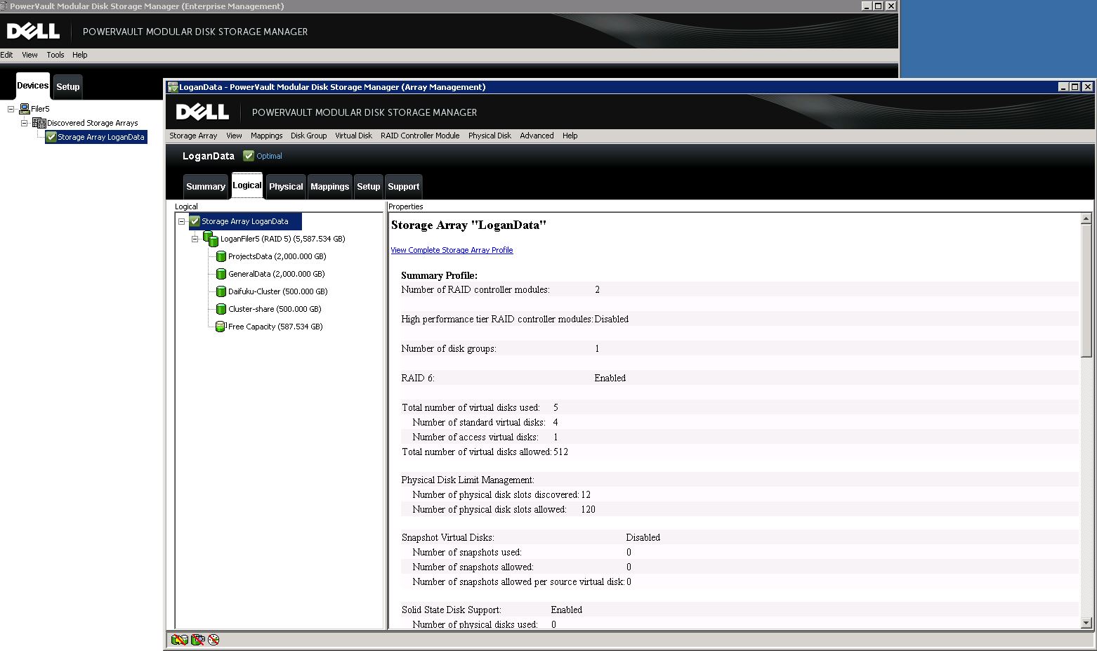

Okey dokey cool it's a Dell poweredge MD3200, i've got it attached on 2 servers at the moment and there setup in a failover cluster.
There is a some management software to install, so i can setup LUN's, storage size, etc, it also installs drivers as well. I've attached a screenshot.

That does appear to be a hardware RAID device. In general, they are not suitable for use with ZFS, since ZFS wants to perform its own software based RAIDing. Basically without raw disks presented to ZFS, you loose some recoverability. And if you present a hardware RAID-5/6 as a LUN to ZFS, ZFS can only detect problems, not fix them.
One thing ZFS was designed to do, was use the computer's main CPU and memory for its software RAID. This is because the computer's main CPU is generally MUCH faster than a hardware RAID controller, (even with application specific hardware assists). Plus, the main computer's RAM is generally much larger than a hardware RAID controller's cache RAM.

I'm not at all familiar with that unit--is it possible to simply present the individual disks to the attached computer? If so, it could work safely, though it's still probably not optimal.
