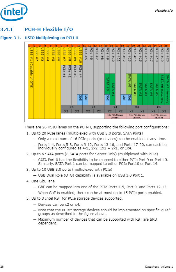

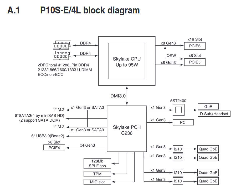

Have motherboard ASUS P10S-E/4L with Intel C236 chip set.
Have problem posted "By start use iSCSI disks FreeNAS system start pull errors - device: ATA error count increased"
By analyze situation why can be problem when work both iSCSI and ZFS.
Since iSCSI use network adapters (GbE), ZFS use all 8 Port 8 SATA devices will be multiplexing of HSIO lanes question ?
For myself, I'm making a note to understand if I load all 8 SATA devices and also use all network adapters (GbE).
Will there be a conflict between SATA0 and GbE under the "Skylake C236 HSIO (High Speed Input / Output Multiplexing) on PCH-H"?
