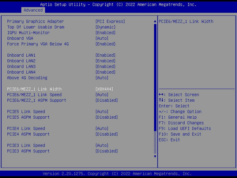

Good: Using IPMI and iGPU simultaneously
Since I run Plex on this machine, I have a Xeon E-2276G installed, and I wanted to ensure I could use the iGPU for transcoding at the same time as using the IPMI KVM. I read about some server boards unconditionally disabling the iGPU when any add-in video card was present, including the BMC's built-in video support. I reached out to ASRock Rack support, who confirmed that with the latest beta BIOS (version 2.41, at the time of posting), both could be used.
Indeed, this works fine. To keep the iGPU from being disabled, you simply have to enable the "IGPU Multi-Monitor" option in the BIOS:
Good: Using PCIe bifurcation on the x16 slot
I didn't expect any issues here, but just want to explicitly document that PCIe bifurcation works fine on the x16 slot (PCIE6). It allows up to x8/x4/x4 (finest-grained bifurcation supported by the C246 chipset), and I've successfully used three NVMe SSDs on a bifurcation riser card.
