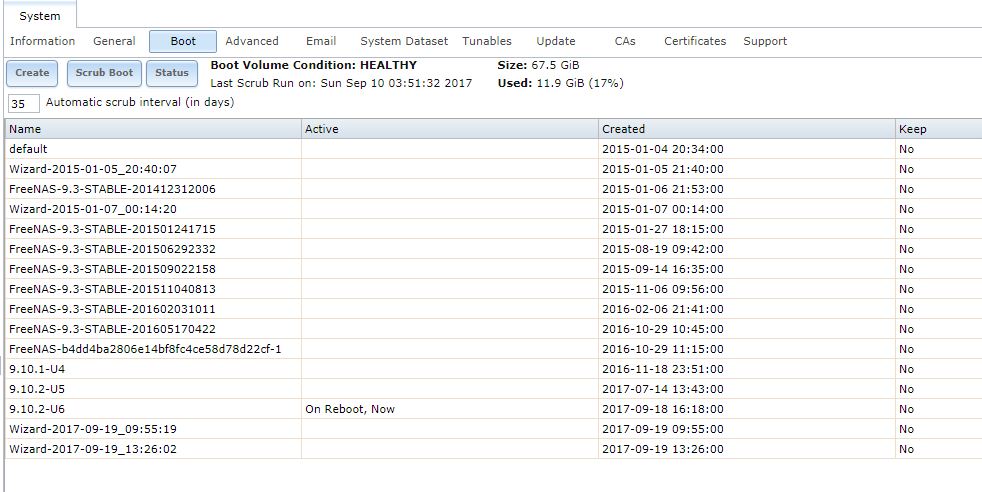

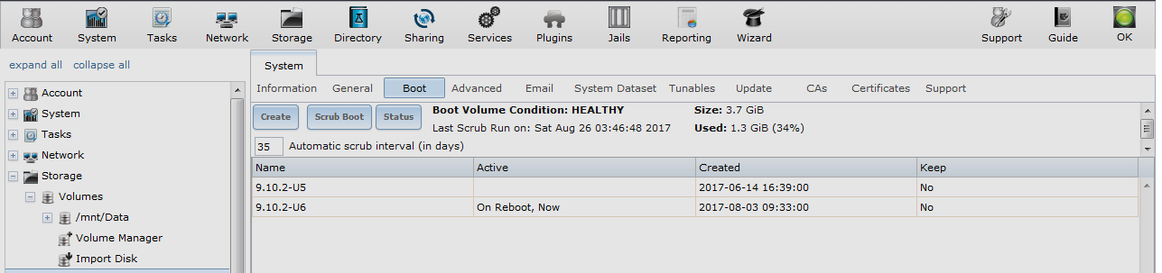

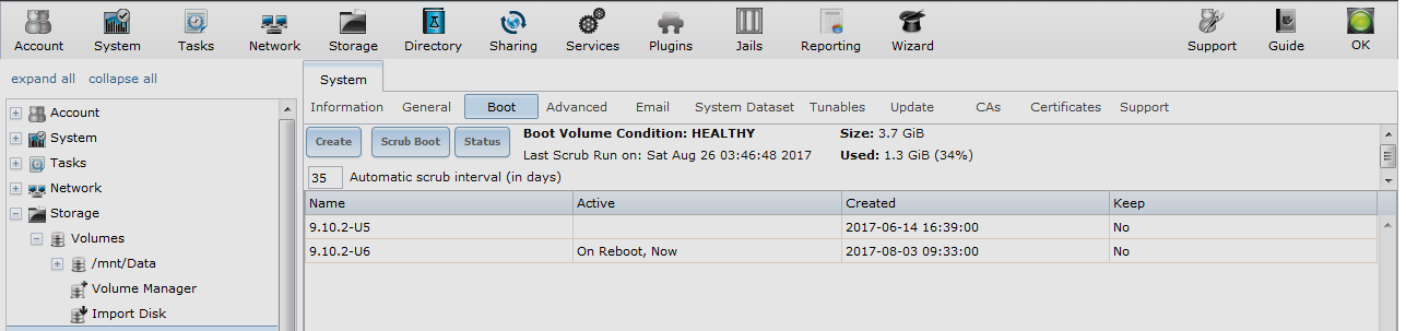

when you upgrade FN it creates a new boot environment rather than deleting the older version. Go to System -> Boot and see what version you went through. See screenshot below:

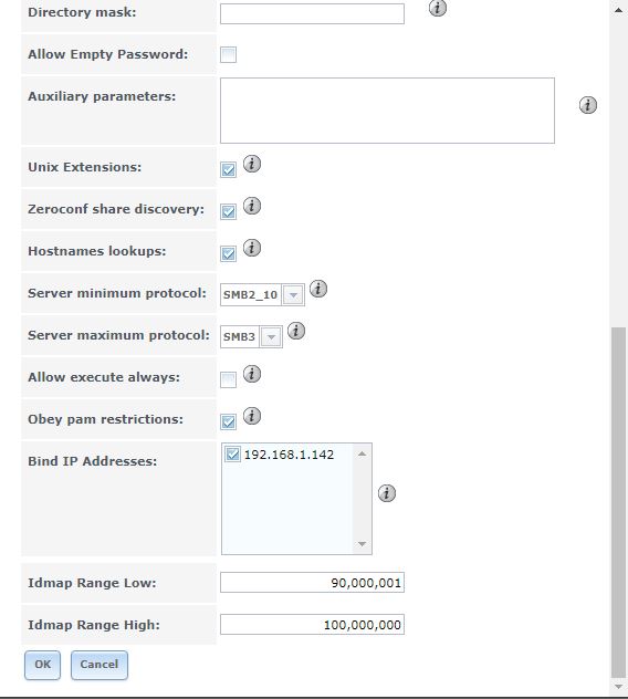

Can you please send some screenshots of the SMB service configuration? as in screenshot below:
Note that for windows 7 the Server minimum protocol option must be set max SMB2_10. My configuration without any auxiliary options works great.
So, first check the dataset permissions, then the SMB service options and last the share options. They must be consistent.
Artion - thanks for showing me that. It looks like I upgraded from version 9.10.1. See below:

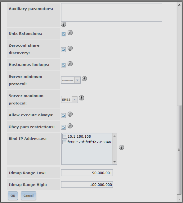

I seem to have encountered a new issue which is likely the reason I'm having this problem. I attempted to change the minimum protocol option for the SMB service and when I saved it I noticed the message at the top of the screen saying that the SMB service failed to start. I have tried starting it again but it says the service could not be started. I also rebooted the server and still have the problem. I see a lot of "unexpected sense" messages but not sure why samba is not loading. How do I figure out why? Here's what I see from the shell when trying to start samba:

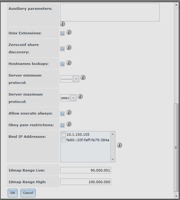

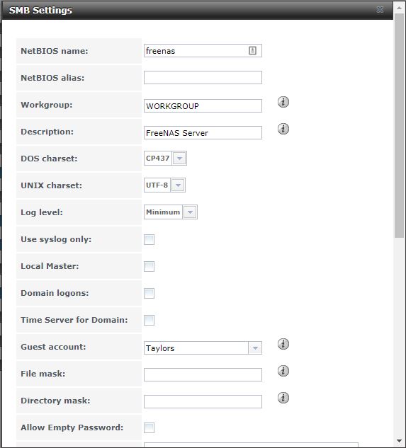

Here's my SMB config. Note that the service has been unable to start since I changed the minimum protocol, but will not start regardless of this setting now.
Tank
Jan 28, 2015
14
https://pastebin.com/raw/2x6rgC3c
SMB appears to have started successfully now. All I did was change the guest account on my dataset to be the same on the service. Not sure if that was the issue, but I still can't connect to the share. I get a login failure error.
