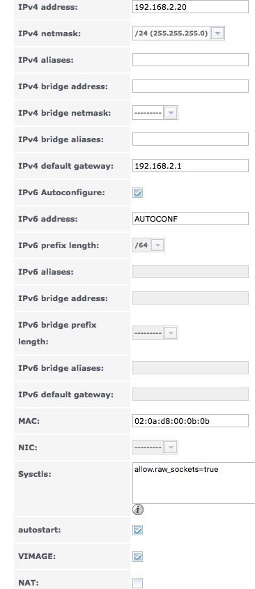

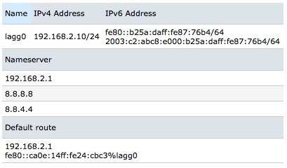

Network -> network summary
and
jail -> edit -> advanced?

Perm1990,
Are you using IPv6 only? Typically I would expect to see an IPv4 address in resolv.conf.
Could you show us the freenas network settings, as well as the jail settings?
and
eldo
Dec 18, 2014
99
I see you're adapter is lagg0. Are you using link aggregation?
Can you test without the lagg configuration? I know from what I've seen on the forums that a misconfigured setup can cause a lot of issues, and it seems a good idea to test simple.
