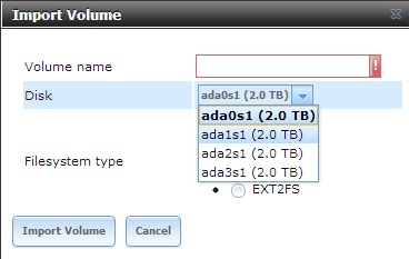

Here is the other strange thing though, when I click on "Import Volume" all four drives appeared. See here.

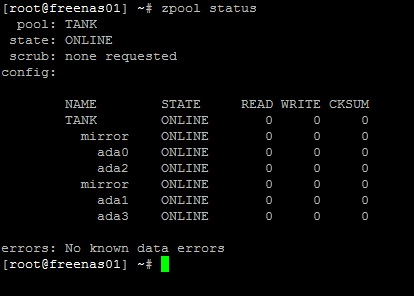

I know the drives can be "used" by FreeNAS as I created a RAID10 zpool via the command line using the following commands.....
zpool create TANK mirror ada0 ada2
zpool add TANK mirror ada1 ada3
(output from zpool status)
I had to reboot the box before I could auto-import the pool though. The pool then appeared in "Storage" on FreeNAS GUI.
