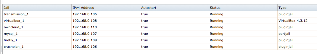

There all installed from 9.2 releases. All of them don't start automatically. I tried to start also with dhcp enabled and/or ip6 enabled, but did not have any luck;)
