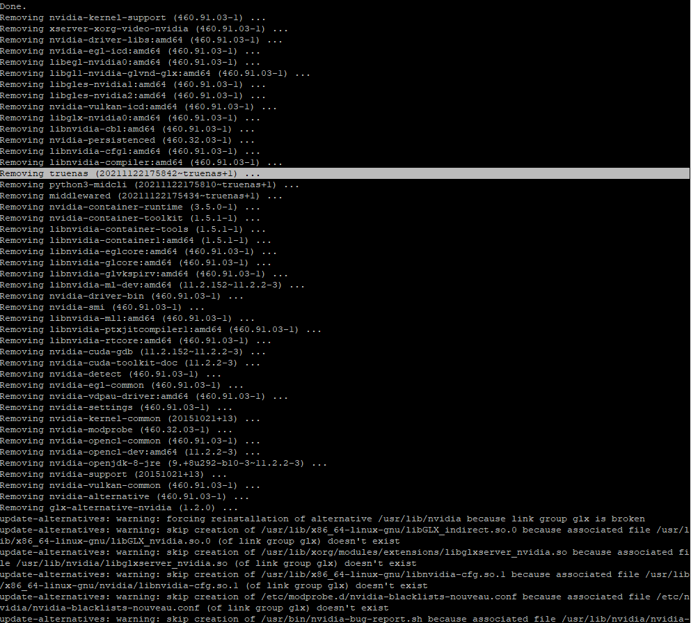

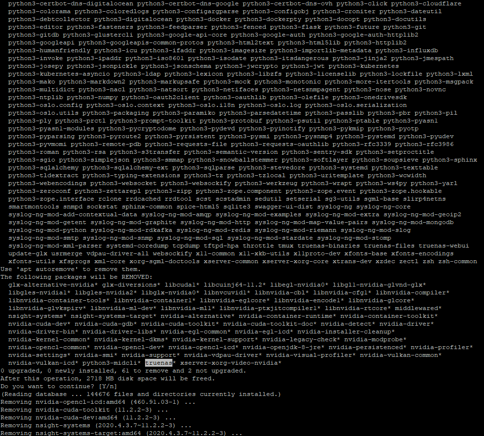

So apparently when you execute
apt-get purge nvidia.
you remove a part of truenas.
I completely missed that and the big question now is, how do i reinstall truenas?
running apt-cache search does not give the needed package.
