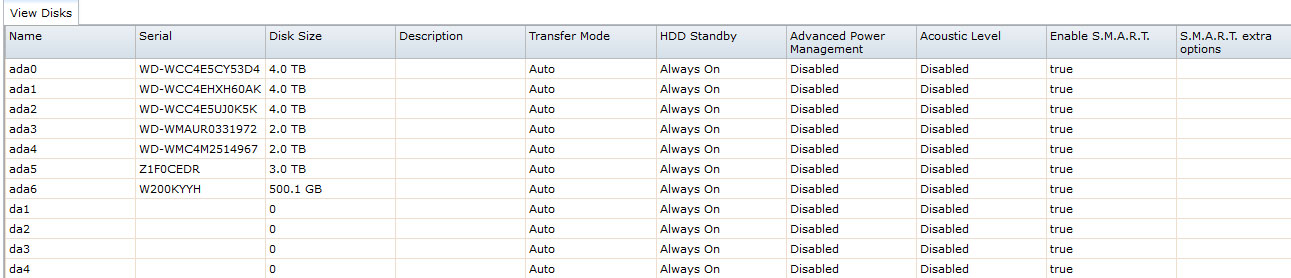

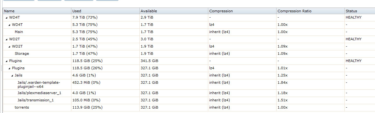

Raycaster
Aug 6, 2015
11
Thank you very much for the replies.
Build FreeNAS-9.3-STABLE-201506292332
Platform AMD A6-6400K APU with Radeon(tm) HD Graphics
Memory 15530MB
System Time Mon Aug 17 20:29:09 EDT 2015
Uptime 8:29PM up 4 days, 5:29, 0 users
Load Average 0.20, 0.10, 0.02

also while you're at it, looks like you have some interesting set of devices hooked into the USB bus. can we see a "camcontrol devlist"?
Raycaster
Aug 6, 2015
11
Raycaster
Aug 6, 2015
11
root@freenas ~]# camcontrol devlist
<WDC WD40EFRX-68WT0N0 82.00A82> at scbus0 target 0 lun 0 (pass0,ada0)
<WDC WD40EFRX-68WT0N0 82.00A82> at scbus1 target 0 lun 0 (pass1,ada1)
<WDC WD40EFRX-68WT0N0 82.00A82> at scbus2 target 0 lun 0 (pass2,ada2)
<WDC WD2001FASS-00U0B0 01.00101> at scbus3 target 0 lun 0 (pass3,ada3)
<WDC WD20EFRX-68EUZN0 80.00A80> at scbus4 target 0 lun 0 (pass4,ada4)
<ST3000DM001-9YN166 CC9C> at scbus5 target 0 lun 0 (pass5,ada5)
<ST500LX003-1AC15G SM12> at scbus7 target 0 lun 0 (pass6,ada6)
<ADATA USB Flash Drive 1100> at scbus9 target 0 lun 0 (pass7,da0)
<Generic STORAGE DEVICE-A 9727> at scbus10 target 0 lun 0 (pass8,da1)
<Generic STORAGE DEVICE-A 9727> at scbus10 target 0 lun 1 (pass9,da2)
<Generic STORAGE DEVICE-A 9727> at scbus10 target 0 lun 2 (pass10,da3)
<Generic STORAGE DEVICE-A 9727> at scbus10 target 0 lun 3 (pass11,da4)
[root@freenas ~]#
