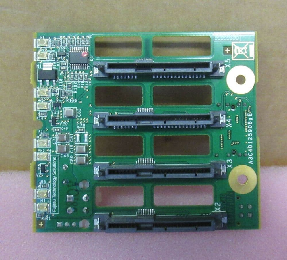

A backplane is a piece of electronics that is mounted in your case behind the slots in which you put the disk drives. It needs to match the controller, the drives, and of course - mechanically - the case. Regularly it comes with the case, already. You connect the controller to the backplane, mount the disks in the trays that come with the case, push in the disks against the backplane.
See the picture for an example. This is from a certain Fujitsu server and it will fit only the case of that particular server and nothing else.

If the question is purely theoretical, the short answer is that it can be both. There are "breakout cables" from one SFF-8087/SFF-8643 to four SATA/SAS for consumer-style cases where drives are wired individually. There are SFF-8xxx to SFF-8xxx cables for server-style cases where (lots of) drives are attached to a backplane, which then attaches to a SAS controller.
