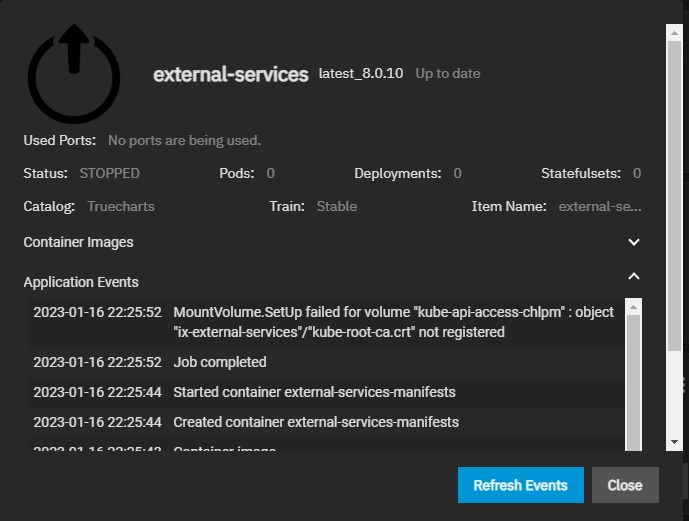

I may have to hit up the TC Discord as when I install External Services, I get the following error and it will not start ? Before I do that though, anything obvious from the below ?
15,504
If that app's going to work as intended, you'd want to enable Ingress, specify a hostname (twice), path (/ is normally right), and cert (ordinarily, or ideally, a wildcard cert from Let's Encrypt, which they cover in a different video). If those things are all set, I'm not sure where the issue would be.
Yeah all those options are set, so I assume it is something else.
