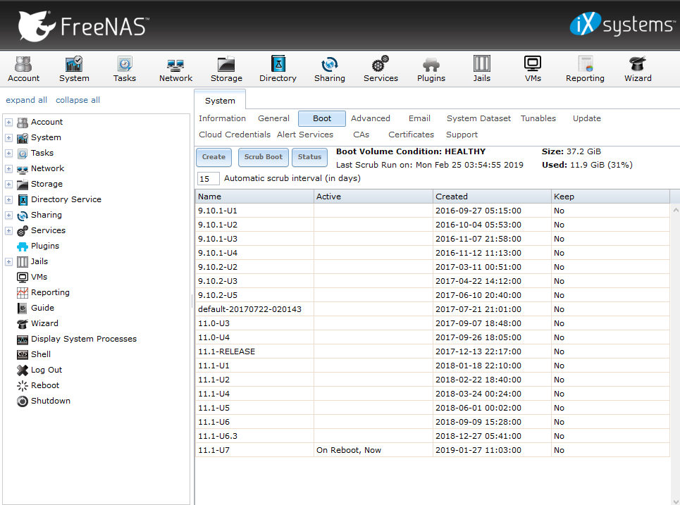

Nothing there... This is still on the 9.3 version. I haven't upgraded yet.

That is just not populating properly. There should be something there, even if it only had the one entry for 9.3. There is always the GRUB menu when you are booting up. The initial menu will only have a couple items, but if you choose to change, it should show you a list of all the other boot environments on a sub menu.

No, it doesn't give an option to load any version. It asks if I want to load a single user or a multi-user. Then it gives the option to manually set the ip and a couple other options but nothing for loading another version.

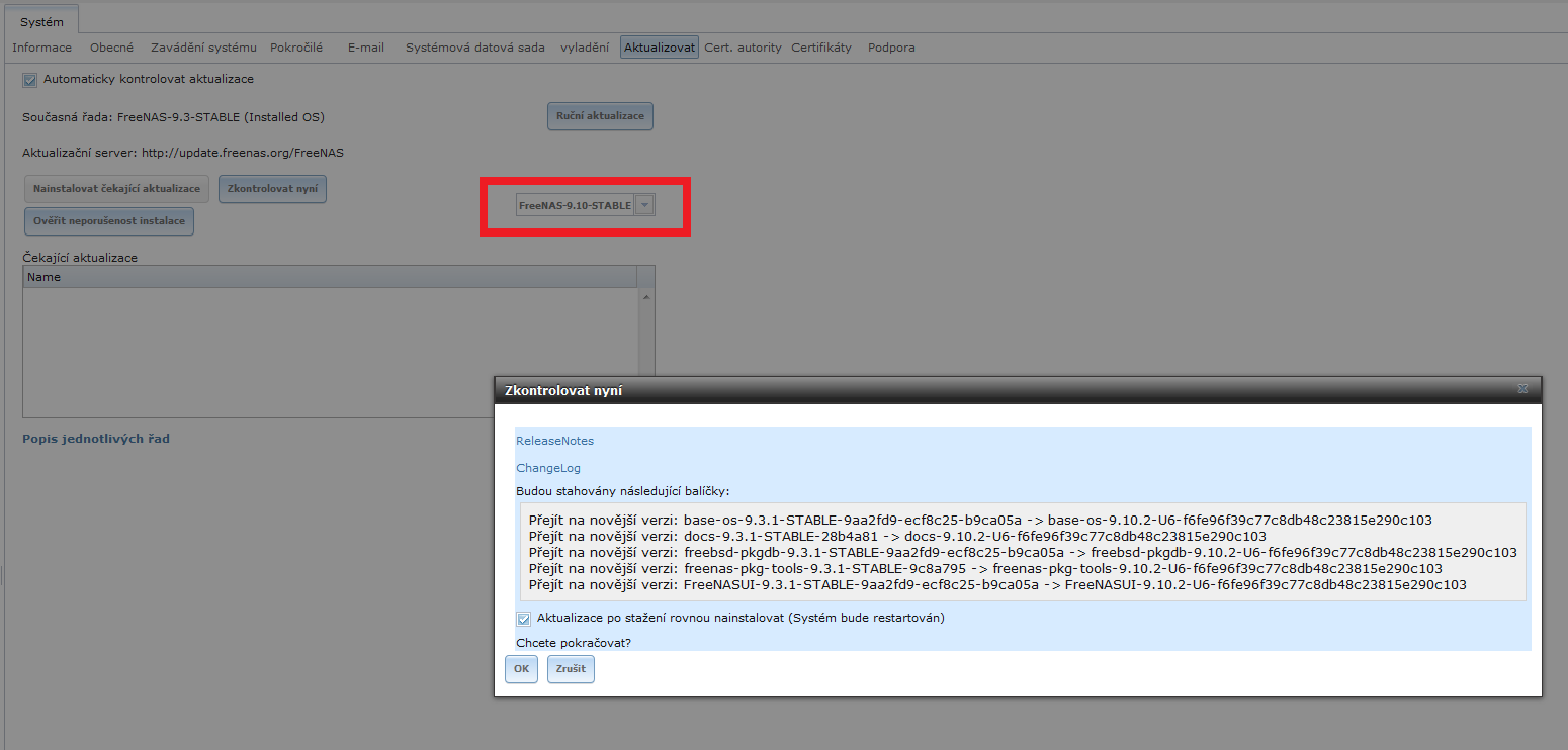

Hi, I'm running 9.3 and want to update to 11.2, auto update isn't working, "Update Server could not be reached", tried some solutions here with DNS and default gateways etc, but didn't helped. Manual update also isn't possible https://www.ixsystems.com/community...-9-3-to-9-10-no-such-file-or-directory.47443/ so I've checked this topic and tried Chris's strategy https://www.ixsystems.com/community/threads/9-3-to-11-2.74303/post-515760 but 9.10 isn't available in his link anymore...
Should I rather do a fresh install of 11.2 and then import my pool or do these manual updates and download 9.10 from somewhere else?

Ah, I finally found archived 9.10 *.tar file, but then tried to change "channel?" in the list shown on picture below to 9.10-Stable and I'm alread
downloading an update...not sure why I cannot find any advice on this :(
