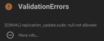

I looked around online and saw that going into Data Protection > Replication Task, checking "Replication from scratch" and saving, I see this error:
Attached is the error output:
Error: Traceback (most recent call last): File "/usr/lib/python3/dist-packages/middlewared/main.py", line 196, in call_method result = await self.middleware._call(message['method'], serviceobj, methodobj, params, app=self) File "/usr/lib/python3/dist-packages/middlewared/main.py", line 1335, in _call return await methodobj(*prepared_call.args) File "/usr/lib/python3/dist-packages/middlewared/service.py", line 933, in update rv = await self.middleware._call( File "/usr/lib/python3/dist-packages/middlewared/main.py", line 1335, in _call return await methodobj(*prepared_call.args) File "/usr/lib/python3/dist-packages/middlewared/schema.py", line 1186, in nf res = await f(*args, **kwargs) File "/usr/lib/python3/dist-packages/middlewared/schema.py", line 1317, in nf args, kwargs = clean_and_validate_args(args, kwargs) File "/usr/lib/python3/dist-packages/middlewared/schema.py", line 1311, in clean_and_validate_args raise verrors middlewared.service_exception.ValidationErrors: [EINVAL] replication_update.sudo: null not allowed
Would anyone have any suggestions as to how I can solve this? My backup replication task has been at state "FAILED" for a few days now.

That makes sense, but once I check "replication from scratch," I receive the "ValidationErrors" and the output following. :/
9,700
OK, so the next error is telling you that you can't leave the information for replication_update.sudo blank... Without seeing the edit screen, I can't tell you which field that equates to, but it should be red and indicating it's not filled.

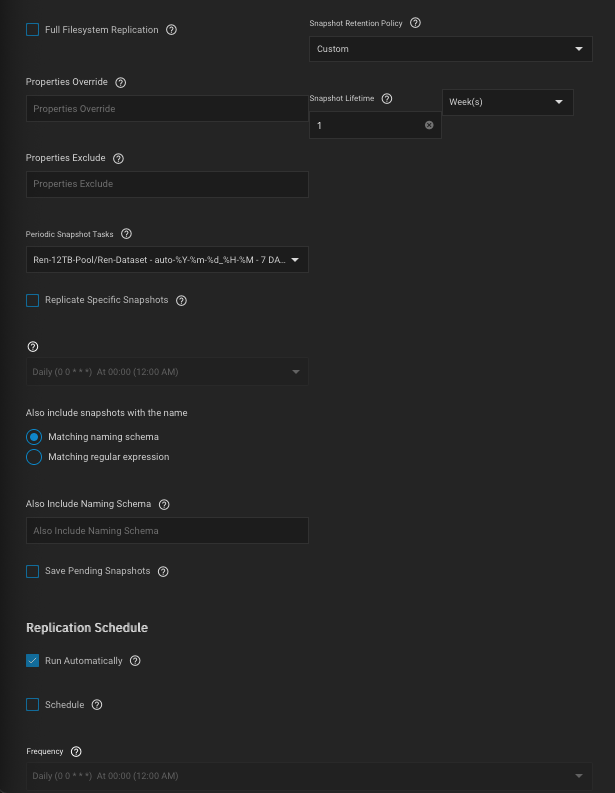

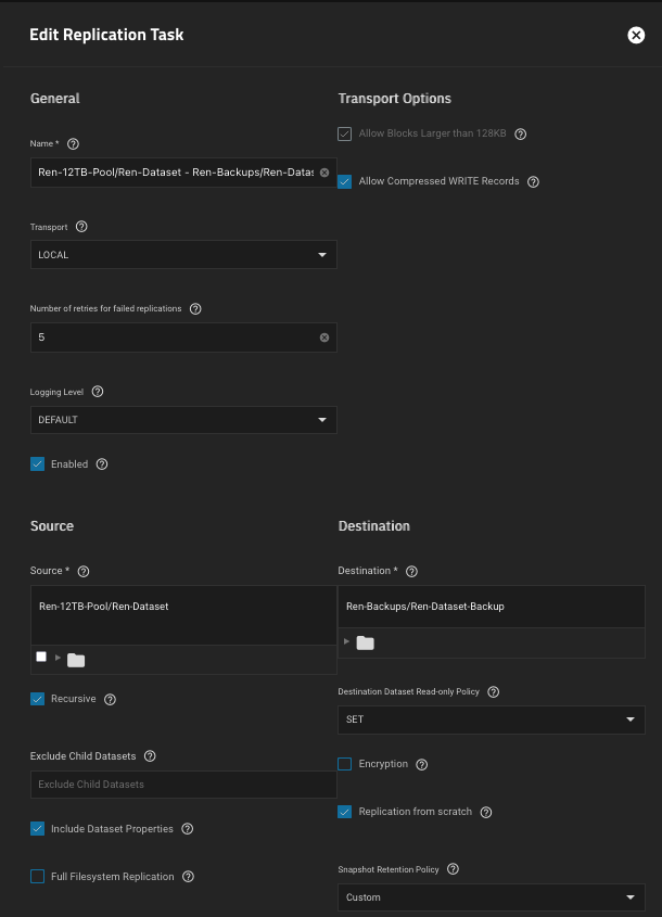

Sounds good! Here's my edit screen. I did just notice that, once I open the menu and hit "save" without changing anything, I get the same "ValidationErrors" message.
