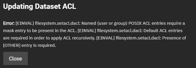

X3n0n
Apr 26, 2021
17
Just add an ACL Entry for "Other" as the error message is asking, it can be with no rights at all but need to be present.
SpinMop
Jun 21, 2021
7
It wants all these other entries. Mask, Other, Group Obj, etc. It shouldn't be like this to add ACL permissions. It should just be pick a user, give them the permissions you want, apply. We can't even change the owner and group of selected storage devices.

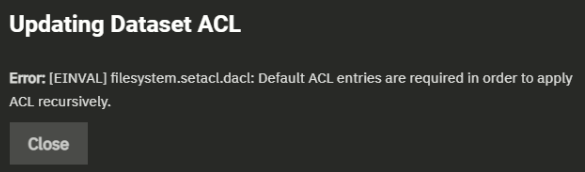

oumpa31
Apr 7, 2015
253
When i just change the owner and group and set recursively i get this
calc
Apr 14, 2021
3
I get different errors on 21.06 depending on how I try to add a group ACL, and haven't found a way that works.
I did find that you have to add a Mask entry before the Group entry, but that still doesn't work as it throws errors about the USER_OBJ, GROUP_OBJ, OTHER not being there even though they are just above the Mask entry.
Note I haven't used CORE previously to using SCALE so I may be doing something wrong, but its far from intuitive even for someone who has used Linux for many years.
Has anyone gotten this to work on a new SCALE install at all?
If so can they explain what steps need to be done to add a new group ACL to a default install?
A screenshot may be helpful to determine what options I missed.
