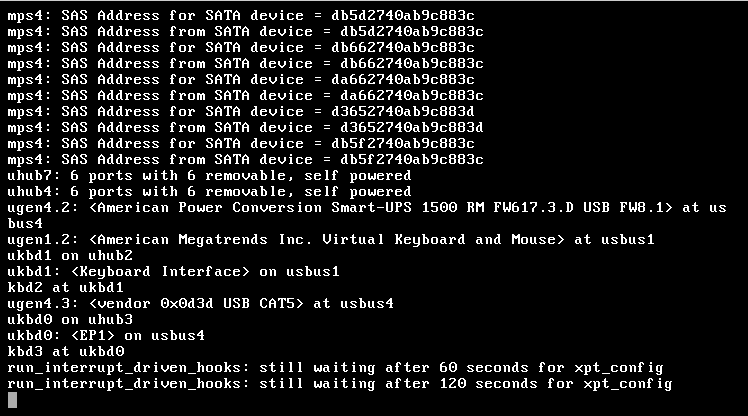

I've been experiencing random reboots from which I have no idea why it's rebooting. I've looked at the logs and there's nothing to indicate why.
I've looked through previous forums, one guy suggested a log server. Great and novel idea. I'd love to have one up and going but I haven't been able to get one running the way I'd like and if I did it would be on this server which reboots. So no help there!
I don't understand why the logs aren't on the pool(s) so they can be looked through and kept for a set period of time?!?
After the reboot the system seriously hangs with the error "run_interrupt_driven_hooks; still waiting after 60 seconds for xpt_config"

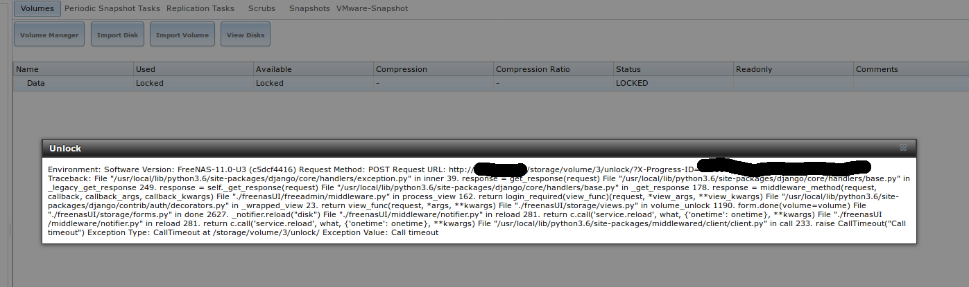

When I decrypt the volume I get an error...
nvironment: Software Version: FreeNAS-11.0-U3 (c5dcf4416) Request Method: POST Request URL: http://XXX.XXX.XXX.XXX/storage/volume/3/unlock/?X-Progress-ID=(REMOVED) Traceback: File "/usr/local/lib/python3.6/site-packages/django/core/handlers/exception.py" in inner 39. response = get_response(request) File "/usr/local/lib/python3.6/site-packages/django/core/handlers/base.py" in _legacy_get_response 249. response = self._get_response(request) File "/usr/local/lib/python3.6/site-packages/django/core/handlers/base.py" in _get_response 178. response = middleware_method(request, callback, callback_args, callback_kwargs) File "./freenasUI/freeadmin/middleware.py" in process_view 162. return login_required(view_func)(request, *view_args, **view_kwargs) File "/usr/local/lib/python3.6/site-packages/django/contrib/auth/decorators.py" in _wrapped_view 23. return view_func(request, *args, **kwargs) File "./freenasUI/storage/views.py" in volume_unlock 1190. form.done(volume=volume) File "./freenasUI/storage/forms.py" in done 2627. _notifier.reload("disk") File "./freenasUI/middleware/notifier.py" in reload 281. return c.call('service.reload', what, {'onetime': onetime}, **kwargs) File "./freenasUI/middleware/notifier.py" in reload 281. return c.call('service.reload', what, {'onetime': onetime}, **kwargs) File "/usr/local/lib/python3.6/site-packages/middlewared/client/client.py" in call 233. raise CallTimeout("Call timeout") Exception Type: CallTimeout at /storage/volume/3/unlock/ Exception Value: Call timeout
After the volume is decrypted the jails do not start nor do the jail's storage mount.

run_interrupt_driven_hooks: still waiting didn't go away. Came got the same error with 9.10.2. Must have something to do with the 2TB drives.
Only way to get it to go away is to power off and power back on.
After rolling back and re-updating all the problems returned.

Which HBA? It might be a driver issue. Some have been fixed for 11.1 and some might not be reported yet.
I'm running LSI cards. If I recall correctly the firmware is version 20 and the driver is 21. I haven't had any notifications for driver updates and these problems didn't start until the upgrade to 11. My server a few times had more than 60 days on it between reboots, now I can't get more than 2 days due to random reboots on top of the other errors.

We stopped adding alerts a few updates ago for LSI drivers as it was confusing users due to the mismatched driver version naming schema and where to actually download the driver for their specific HBA. Please double-check that you do have the latest driver for your HBA.
