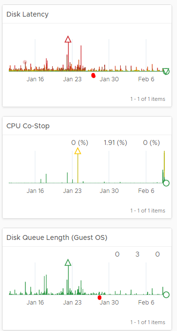

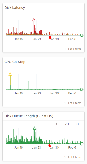

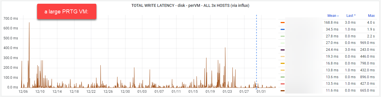

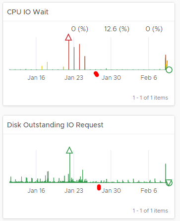

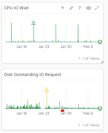

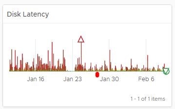

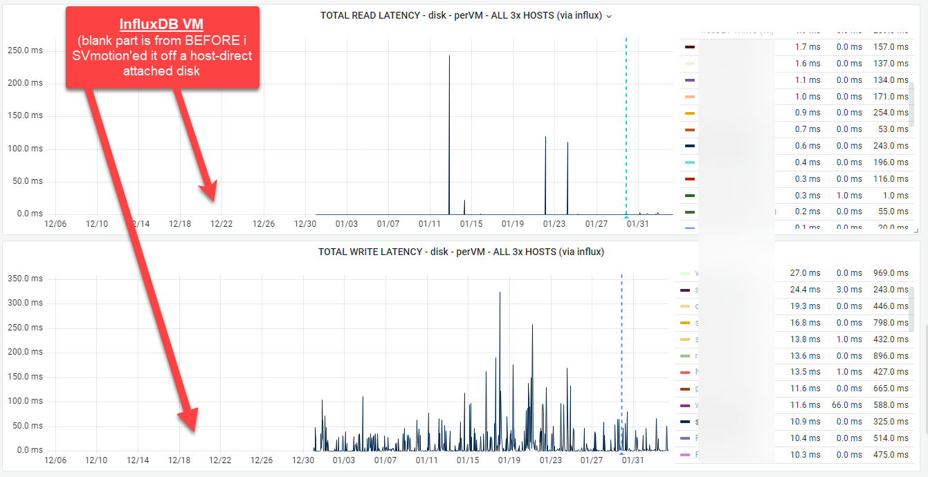

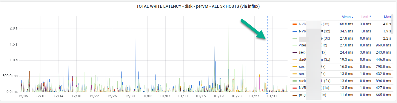

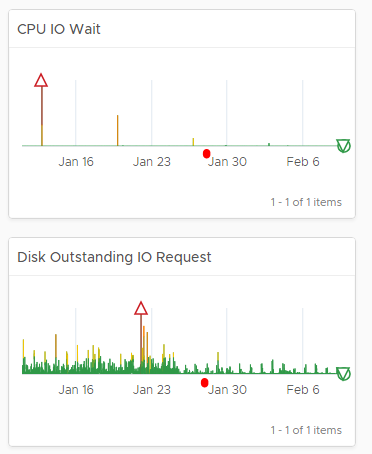

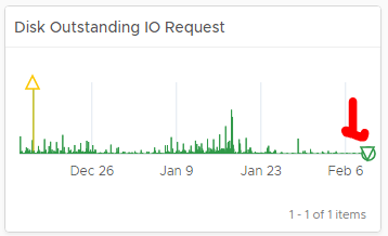

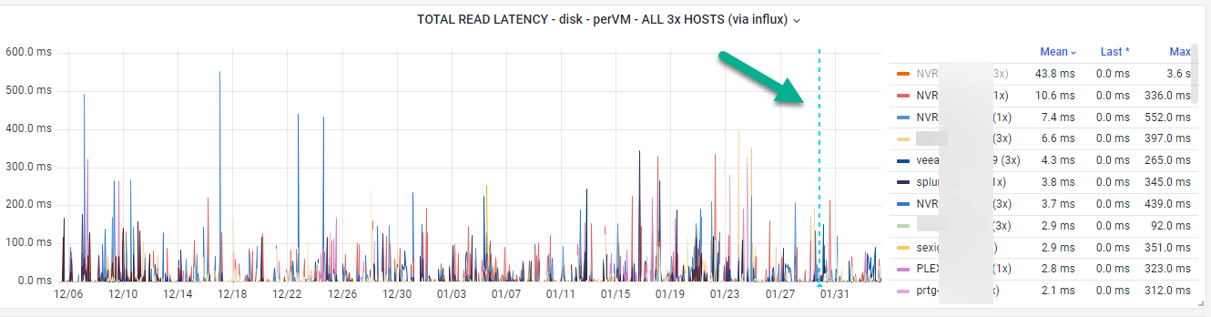

the most important metric i feel is the NFS disk latency as reported by vSphere, that the hosts are experiencing TO the TN datastores (the images / graphs below) :
some notes on the 60-day graphs below:
below are 60day graphs, the blue dashed line is when the 11.2 -> 13 upgrade was completed, these stats are pulled from vSphere (1st img is all vms):

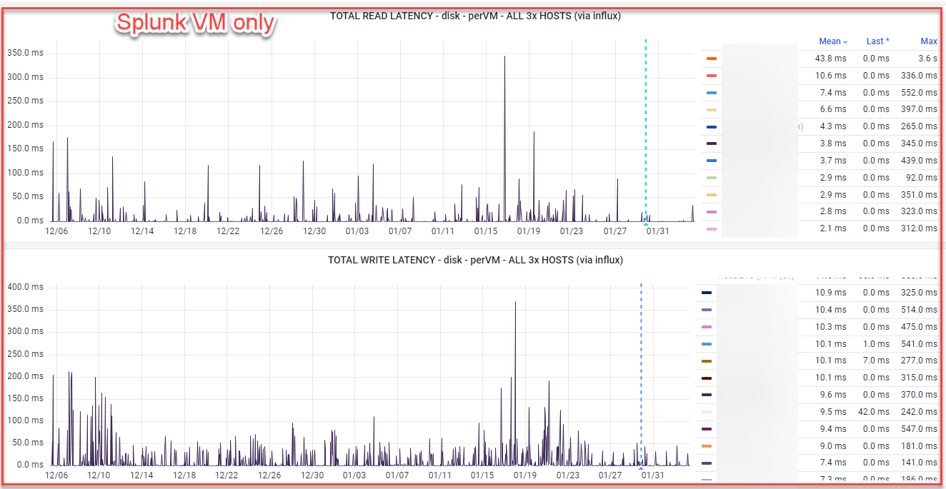

+ Splunk VM (uses my nvme mirror via NFS -> TN)

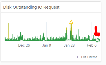

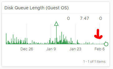

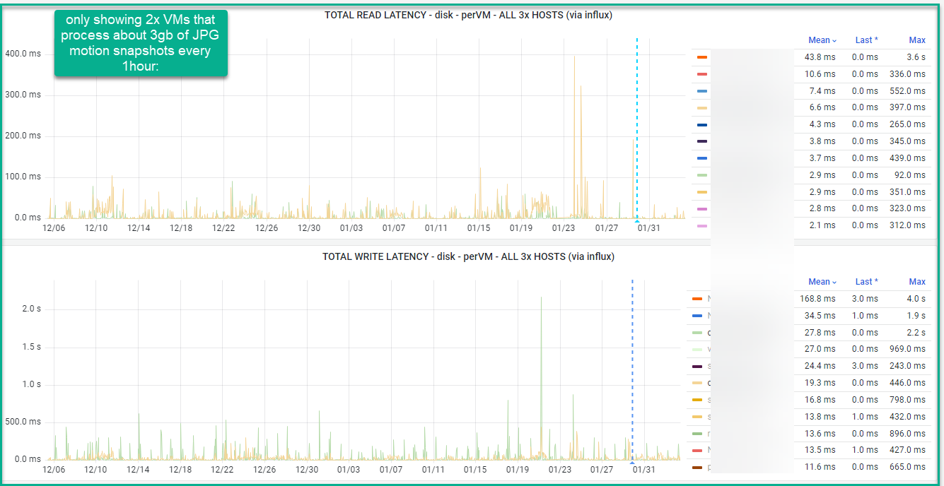

* for about 10days prior to the 11.2 to 13 upgrade, i was doing a 1 by 1 disk "upgrade" of 2x of my pools (swapping their 8tb disks for 16 tb disks) so that did add quite a bit of load / latency due to the many re-silvers that had to be done for each disk in.
* my other post linked below, might also be relevant to the increase performance / decreased latency post 11.2 -> 11.3 FN upgrade (TLDR: my ssd pools were seeing CONSTANT delete IOPS, *possibly* due to TRIM being enabled by default on 11.2, but disabled by default on 13)
