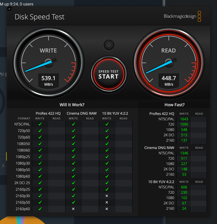

NFS works, but it's nearly half the speed at 500mbs read / write which isn't useable for Final Cut Pro Video Editing Setup.

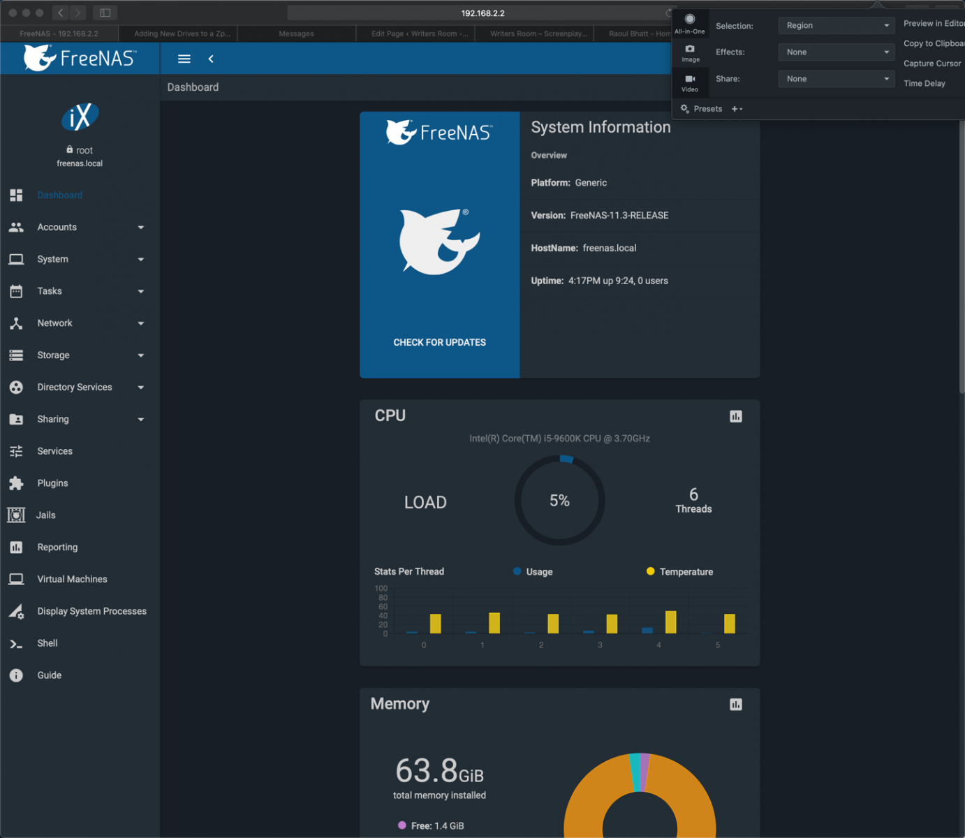

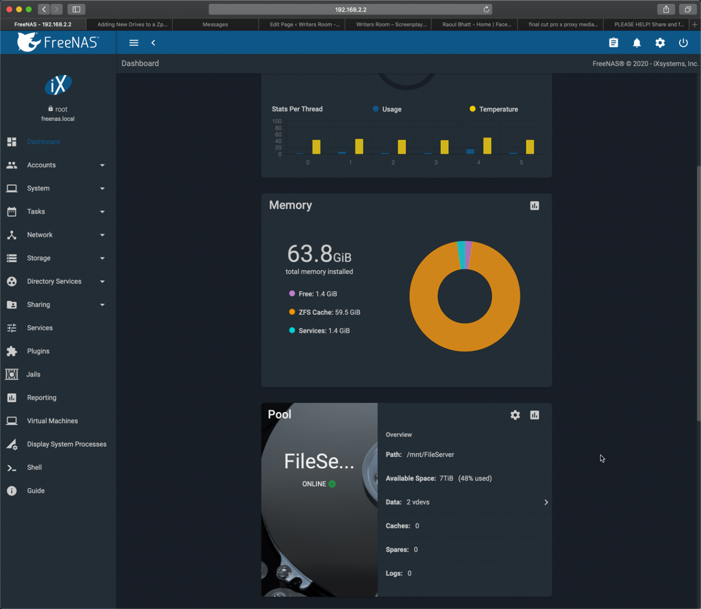

I’m running 64GB on my server, but by these screen shots, the memory seems maxed out.
I installed Freenas on my Nvme drive which has a read write of
Maximum Sequential Reads: 3,200MB/s
Maximum Sequential Writes: 2,200MB/s
The network card I'm running is the Asus AQtion AQC107/XG-C100C
You're mixing units... mbps and MBps are not the same thing by a factor of about 8.
If I assume you're talking only about MBps, then there are a few things you can look at in addition to doing the bottleneck search suggested already with fio and iperf3...
