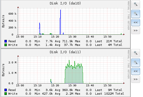

Still on gigabit while awaiting new parts (running with a G2130 pentium at the moment and onboard gigabit ethernet, and only 8 drives, and some of the drives are on the onboard sata, but the rest of the config is the same), however, I am very concerned with the performance I am currently getting about 20mb/s write and 3mb/s read speeds with the 4x2tb mirrored vdevs in the pool and the file transfers seem to be only going to some of the drives. Originally built the pool with 4 drives, moved over my data which went fairly quickly for 2tb, only a couple of hours or so, then expanded the pool with two more pairs of drives as shown. I tried scrubbing the array, but the results are the same, and it only seemed to scrub the 3 disks according to the drive io graph in the reporting as well. With a 5 disk raidz2, I was getting 115mb/s write speed and 96mb/s read speed. From what I've researched, the more vdevs in a pool, the faster the performance, and simple mirrors should use far fewer resources than a raidz2.
Any help is greatly appreciated. Updated the thread title appropriately.

You can't test performance using that GUI tool. You should check locally in the box then test network speed second.

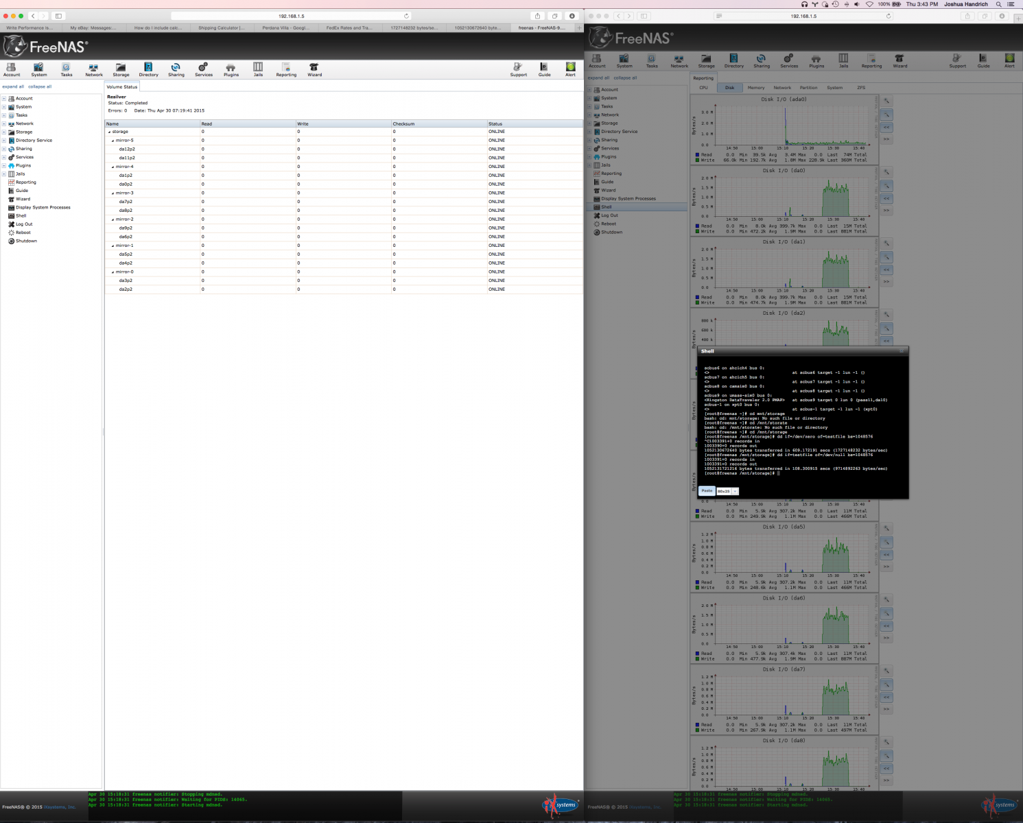

Following this: https://forums.freenas.org/index.php?threads/write-performance-issues-mid-level-zfs-setup.13372/ Here are my results. The resulting test file was a hair over 1TB
Also, swapped in the xeon and my sas sff cables came, so I'm running with 12x drives in the pool as mirrored vdevs. Just waiting on 4x drives now and the network card, switch, fiber cables, and macbook card and thunderbolt 2 enclosure.
Second picture: still seems to like to ignore one of the disks in the pool, but smart checks and scrubs have no errors.

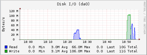

Ok, turned off compression to get more realistic test results (with 12x2tb in 6x2 striped mirror):

Created the pool from scratch with my data on other disks to move over. All hard drives are being written to evenly with the stripe now.
Not gonna saturate 10gb, but gonna stick with 12 disks for now and possibly expand later. Fairly happy with the results. Though kind of surprised that the write speeds on what is essentially a raid 10 array would be significantly faster than the read speed, though neither is disappointing. Will play around with network options and sharing protocols on monday when my fiber cables and switch arrive.
