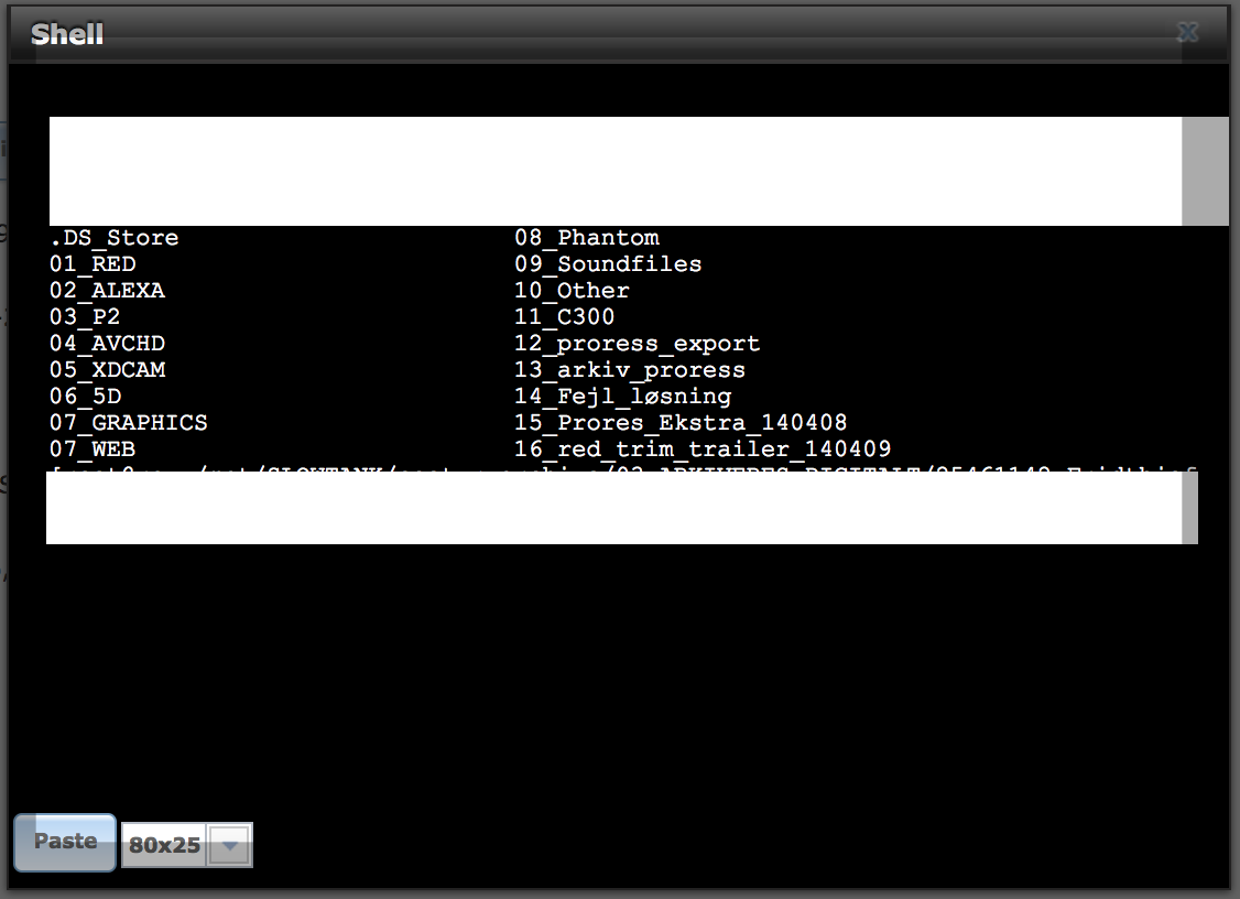

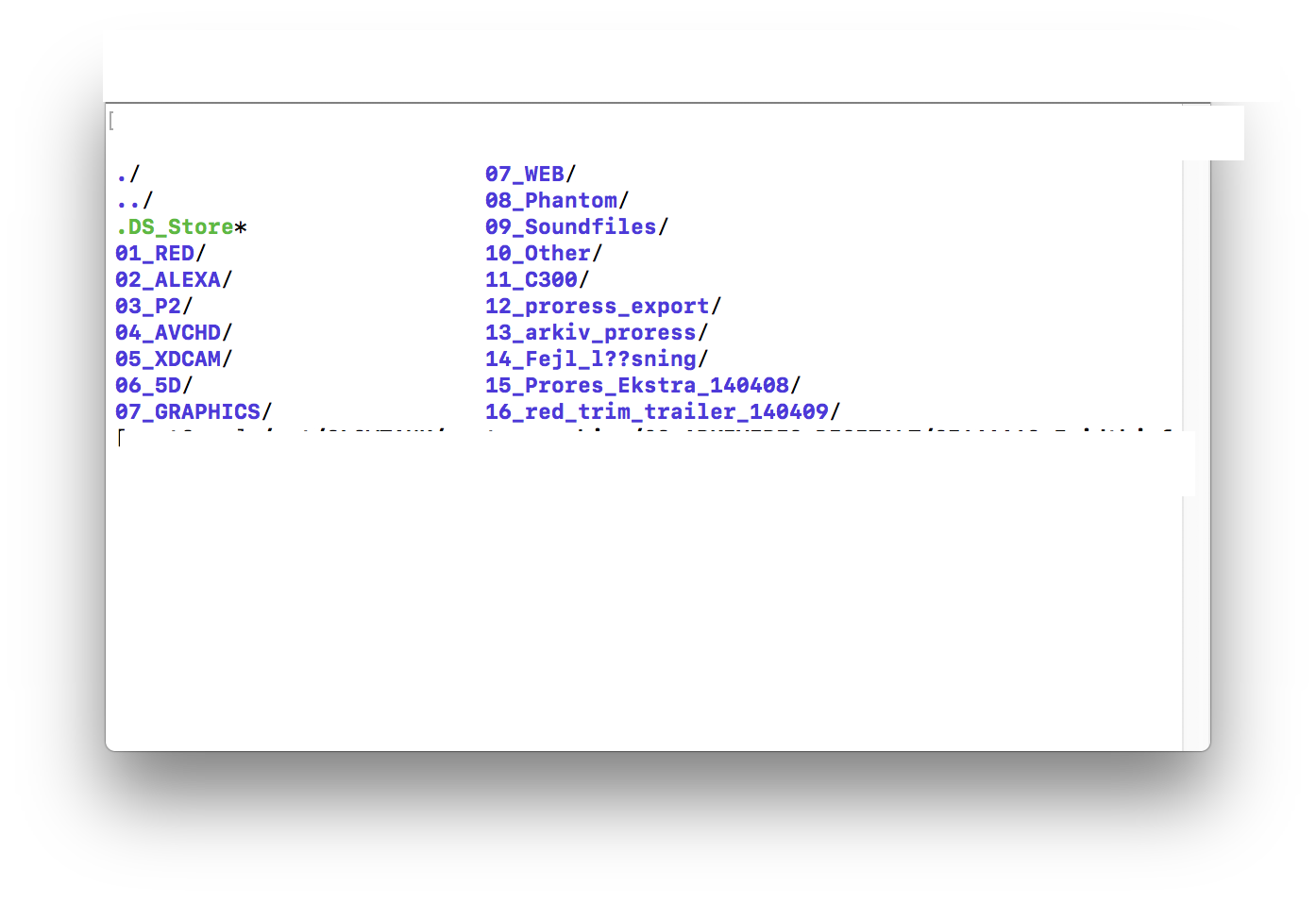

Is you can see in the attachment then the directory 14_Fejl_løsning is spelled correct in the web gui Shell, but connected through ssh is it not.
Shell:
SSH:
